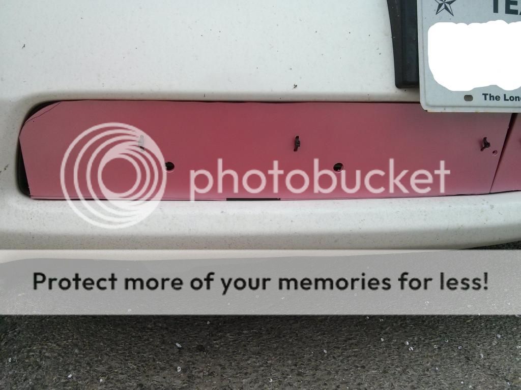

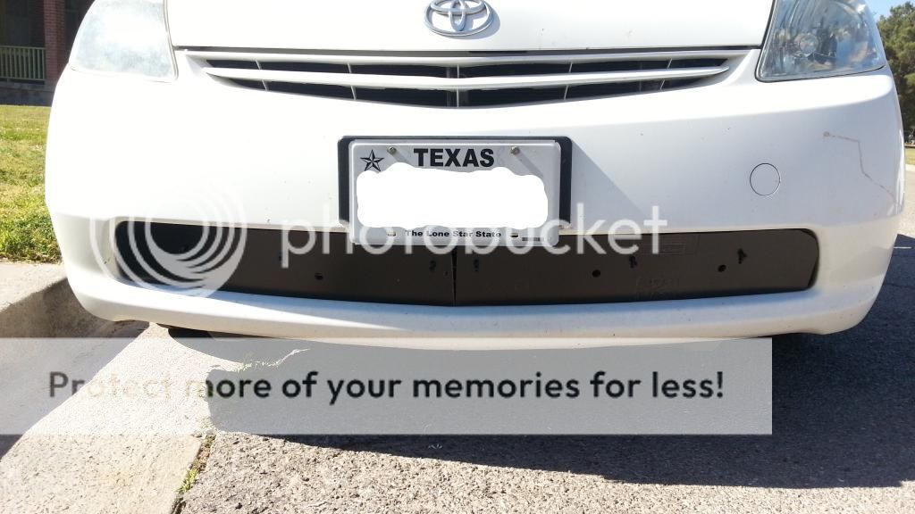

    I made the grille block for my Gen 2 out of the back panel of a broken pink 32" LCD TV I found. I zip tied it on the front of the grille.
    Close up of zip ties.
    After painting it black.
    No matter what method you use, I would recommend having a Scangauge, Ultragauge, Torque app, or some other way of monitoring the coolant temperature.
