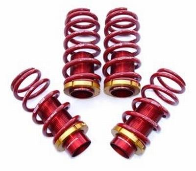

    *Old car* Ground-Control Coilovers (Toyota Matrix),Rear Tokico HP's, OEM Corolla 24mm front sway bar, TRD Corolla 24mm rear sway bar, 225/50R15 Kumho V710's(for autocross), Gen 1 Prius inverter radiator, HV Battery fan controller
    But what years work? The 2003-2007 correct? Ground Control Coilover Kit PONTIAC VIBE 2003 - 2007 8070.01

    What about the Skunk2 kit also?

    Yep up to 08 actually. I would assume the Skunk2's would work as well.

    Wow... good to know - Probably worth the difference unless you want the "Go-Cart on rails" effect to spend the extra on the GroundControl brand? I take the similar ride with the Eibach lowering springs (ones that don't work with the touring model) are because Ground Control uses Eibach springs with their strut mount coilovers?
    Obviously your stock shocks will wear out sooner...with the extra compression. Any other parts that are swappable... Also, can I expect the Touring model to work with these swaps?? :)
    ~$430 Ground Control - Spring Rate: Moderate - maintain closer to stock (saying this modestly) ride as possible.
    Part #:8070.01
    $275 Skunk2 - Spring Rate: Harsh - much stiffer ride.
    Part #:517-08-2450
