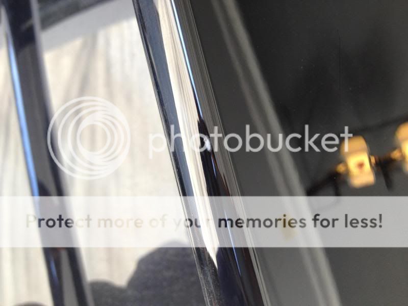

    I was in a low-ceiling car garage when I opened the trunk of my Black 2010 Prius and it hit a copper pipe in the ceiling and got this ding. I attached a pic of it.
    I'm now desperate in trying to figure out how to repair it - either through a scratch remover or touch-out paint.
    I'm sooooo mad at myself :mad:!!!

    It's hard from that picture to see what I'm looking at. Painless Dent removal guys usually do pretty good work at getting any dings or dents out. If its a scratch only in the paint, Dr. Colorchip usually works, but a professional Body Shop fix always works 100%.

    I don't see it either. If you need to touch up the spoiler Toyota 202 Black is a perfect match.

    Its that tiny white hole (pretty small when you see it in person.)
    I have gotten the official Toyota 202 Touch-Up Paint from the dealer. The dealer told me not to bother with the clearcoat (is he right on that?) Why do I not need clearcoat?
    Also - he advised I probably use a toothpick and start layering the tiny hole - one layer at a time, until it fills the paint gap...
