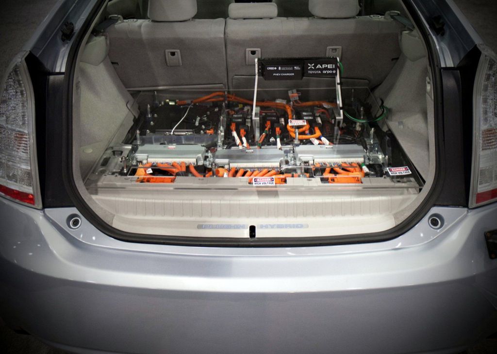

    The new SiC charger was demonstrated with PiP. The video shows the difference in size allowing it to mount it in other places (now in spare tire well).
    The best benefit of it is the 6 kW charging. It would cut the charging time from ~3 hours (bundled standard charge) to about half an hour for ~80% full.
    Efficiency is higher too, expected 95%+ and ultra-high power density of 3.8 kW/k. It is supposed to cut the charging loss from by 5% (now ~15%).
    It probably won't make it to NS4 or Gen2 PiP. I am hopeful because NS4 vision was to reduce charging time while boost the EV range. With SiC power inverter and charger, it'll certainly achieve that.

    Charging from "any available A/C outlet" is a bit misleading. 6kw would be around 60 amps at 110v, which is the voltage at most available outlets, and very few are rated for more than 20 amps. I do not know- is it safe to charge the plug-in in 1/2 hour?
  5. bisco
    107,781
    48,985
    oh ya, i charge mine in 90 minutes now. 240v. i think it depends more on the charger than the battery.

    From the rate that regen recharges, it can make it full in under 10 mins, so it is possible.
    I would not want to do that unless the plugin is designed from the gecko.

    I question the 10 minutes. I just did a long downhill at 55 mph and regen was 150 wh/minute. That would be 20 minutes for 3 kWh. At that rate it kicked on the ICE after 3 minutes so it wasn't entirely happy with the cumulative regen action but that may have been because of the 55mph. Later on a shorter run it was happy at that rate and 45 mph for 4 minutes and that was the end of the run.

    Above ~75% SOC, regen power is reduced. Going over the threshold would turn on the ICE. You can monitor the threshold in Torque.
    10 mins was my theoretical estimate. In practice, we'll have to consider things like variable rate, temp difference, etc.

    Note that plugging in to a typical ordinary 30A 240v J1772 public charging station for a PiP with a 6kw charger on board would be equivalent in battery stress to a Model S plugging into a Tesla supercharger or a Nissan LEAF plugging into a CHAdeMO DC quick charger.
