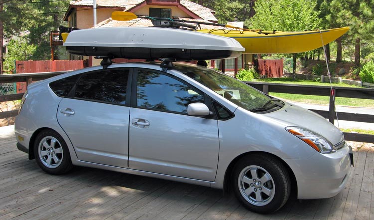

    My favorite cargo-extending solution is a cargo box on the roof... thusly. Advantage is that it doesn't tax just the rear end of the car, and it is always out of the way. Disadvantage is that it causes more air drag and is tough to reach for the height-challenged.
    [IMG]

    ^^^ That's sweet lookin. Goes perfect with the car. What brand is it?

    Who is the rack manufacturer in your photo? I'm looking for a roof rack that can be easily taken on and off and that will not require any permanent mounting or mar the finish. Will this one meet those criteria?
