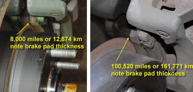

    BTW, here's a site where Wayne Brown posted some photos of his like-new brake pads at 100k miles:
    http://privatenrg.com/#100kBrakePads
    [IMG]
