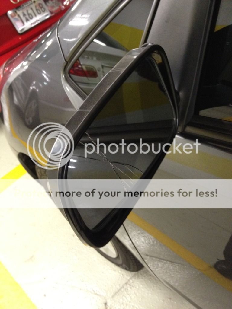

    So two weeks ago I'm sitting at a stop light several cars back, but at a complete stop. There are 3 lanes going straight of which I am in the far left lane and next to me there are 2 more lanes for making a left turn. Well out of nowhere I hear this loud "bang!" and realize some a-hole in a new BMW 328i just clipped the mirror to my Prius. It appears to me that he was trying to beat the left turn light and with his lousy driving skills managed to come so close to me that his passenger side mirror clips my driver side mirror. So I see he didn't make the light and it appears like he would have kept going had the light not been red and I pull in behind him and get out. I walk up to his window and inform him in a rather pissed off way that he just hit my car. He said "Yeah" and I look at him like are you going to do anything about it or you going to just keep on going. So at this point I take a picture of his plate just in case he tries to run and we agree to pull over in the parking lot across from the intersection. While pulling into the lot I call the local police to get a report on file and shortly after they show up. The BMW driver admits fault and according to the cop he is supposed to receive a ticket, but lets him off. Wth!? :mad:
    Anyway, new mirror and cover ordered online for about $100 less than dealership prices and I plan to save the $100 it would cost to replace by doing it myself. Anyone have additional tips/advice on the swap?
