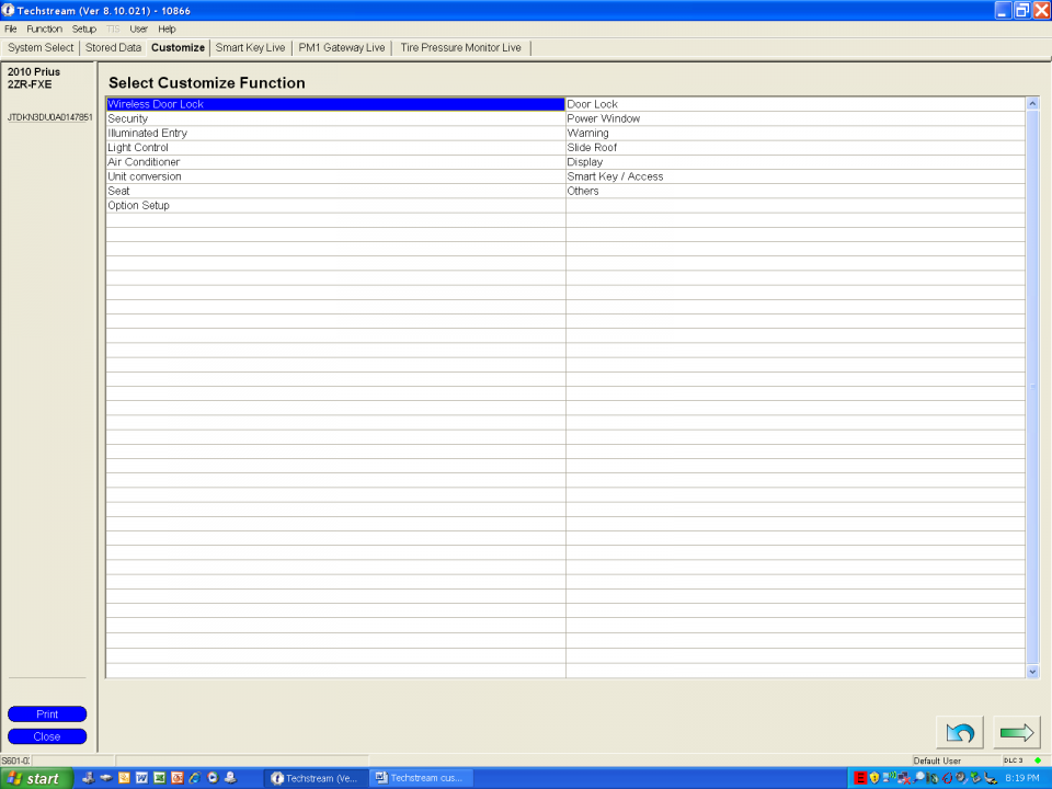

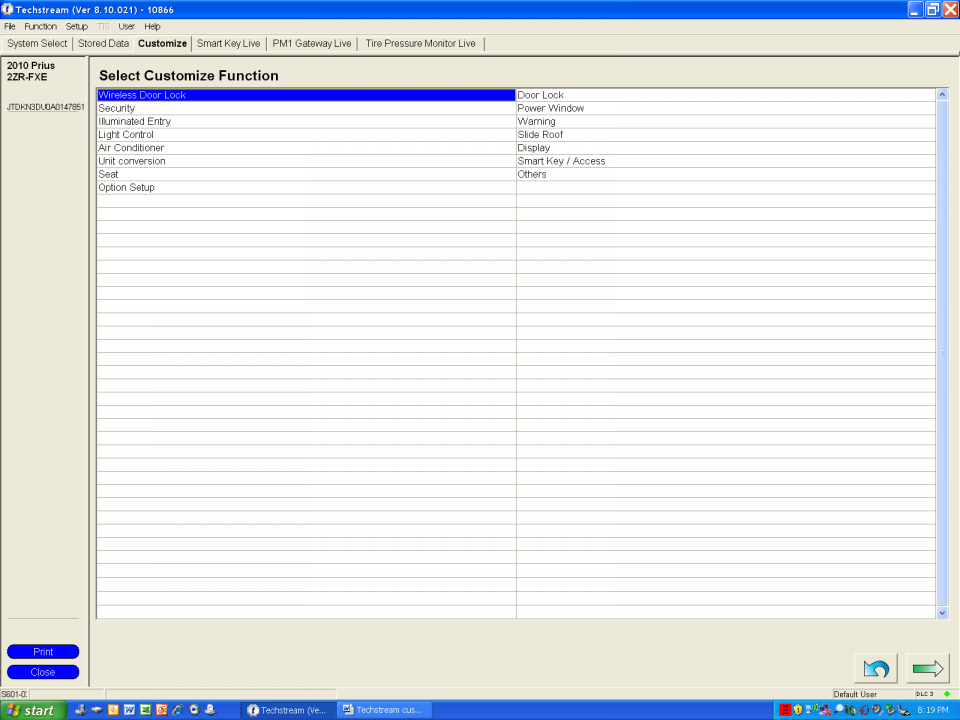

    After that it’s easy. Just select the third tab from the left, Customize, and it will look like the picture below.

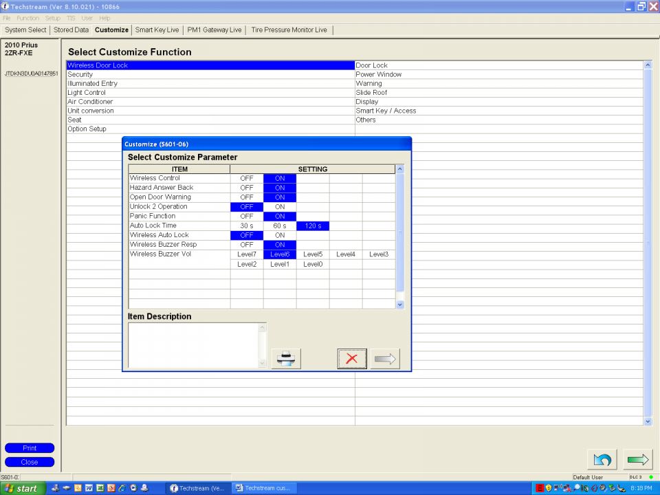

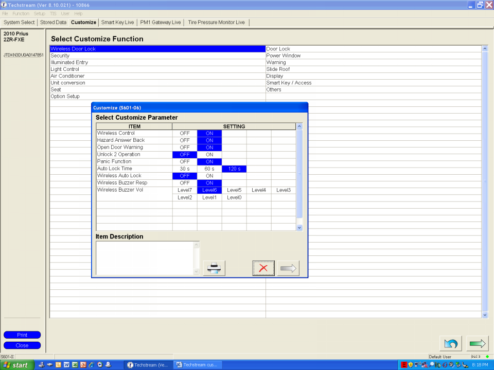

    Next select one of the Customize Functions and a small box will pop up with parameters. (See picture below)
    If you click on the parameter, an explanation will show in the Item Description box below. After you are done selecting parameters, click on the arrow in the bottom left of the small box and it will ask you if you want to save. Select “Yes” and move onto the next Function. You will be amazed at the options you have. You can even turn off the seat belt beeper on the driver or the passenger side or both.
