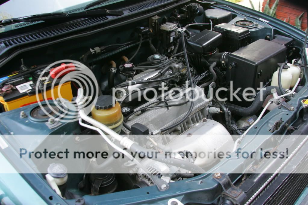

    I use the car wash sprayer once or twice a year and avoid directly spraying electrics. Here's what my old Rav4 bay looked like at 13 years old.
