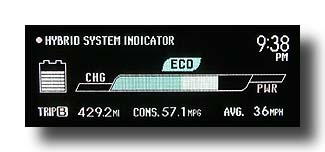

    It works exactly like STEALTH mode works in the regular Prius.
    46 MPH is the maximum speed and EV is available until you hit white, the same way my 2010 did it...
    [IMG]
    ...then in white, the engine runs until you return back to green.
    Also, it won't deplete entirely. That stops at 0.1 miles and holds the last remaining bit of electricity until you switch to EV mode.
