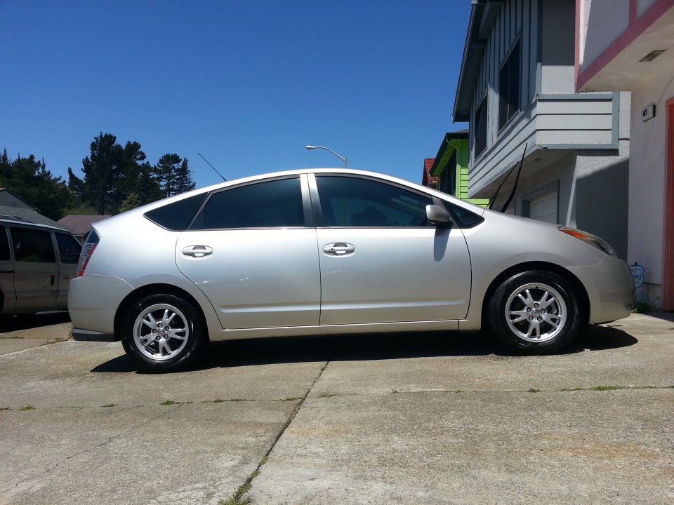

    I'm currently running tires and rims from a gen3 prius. Fits perfectly.
    Why? I bought the stock rims w/new tires for $350 on craigslist because the guy wanted to increase the wheel size on his gen 3. And I was able to sell my gen2 wheels w/worn for $150 for the set!
