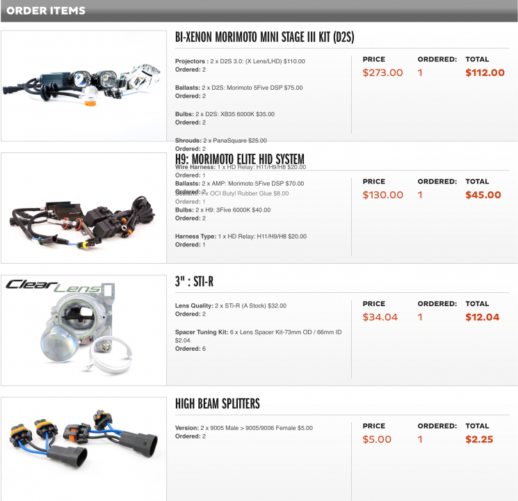

    Hey, I finally have some time on my hands an pulled the trigger on doing a Quad projector with a Super bright led Fog with Audi Style DRL and my Personal Turn signal Drl mod. So here is what I bought from the retrofit source. Mini d2s fore high beam and low beam. Clear lens for the stock projectors. to top them off a some fabulous foglights! Screen Shot 2014-10-26 at 7.37.57 PM.png

    What's the H9 kit for?
    Have you done any previous retrofits or is this your first? Suggestions heavily depend on what your experience is!
    I am sure it will look awesome though

    The h9 is for the h11 stock projector. First full retrofit. Have installed HIDS before

    Oh... You are putting a HID kit in a halogen projector (or is it LED on the PiP?) and then retrofitting 1 projector additional for the high beam?
    If you are ripping apart your headlights, do it properly and do a full retrofit. Take out the projector behind the stock area and replace it with something much better and designed for HIDs. Also 6000K bulbs are not a good idea. They make it look very ricey and have less output than 4300K bulbs. 5000K is about as high as you should go because remember after a few hundred hours they colour shift. So 4300K bulbs become 5000K bulbs (ish) and 5000K go up to 5600K-6000K. Your 6000K will go up to 6600K-7000K which is not in the realm of real.
    I commend you for taking on such a big challenge for your first retrofit. I would recommend buying a second pair of lights off of eBay or a junkyard too. To do it properly will take many hours. My retrofits if I have time to work on them non-stop usually take the weekend because of dry times for various glues and such. You can of course cut this down if you do things ahead of time on the bench, but I prefer to build the retrofit "on the car" versus "on the bench". And if they are not aimed properly you are ripping it all out and starting over. So having a spare headlight assembly for when 3am Sunday morning rolls around and you have to have the car on the road the next morning for work is a life saver. In CA you will most assuredly be ticketed for driving without headlamps.
    If you are hell bent on using the stock projectors (which are pretty crap, and output light in the wrong spots) at least cover part of the squirrel finders so you don't blind incoming traffic. You will be in there anyways so it is just an extra piece of anything and some glue.

    Yes that is right, hid in halogen projector, and retro fit in the high beam. I chose 6k becasue its a 65watt ballast for the h9 (I also got D2s too and added the clear TSX-r lens) and 55watt for the D2S so the 6k should trickle dow to 5k or atleast 5.5k. For the stock projector, my Lexus Rx's headlights broke tabs when it got hit, so i am taking its AFS projectors out and retroing those into the prius for its low beam, unless cutting the stock headlight gets annoying then i will just use stock projectors. I have 2 headlights from my PIP back when i got hit by a drunk driver, they also just have broke tabs and front plastic.

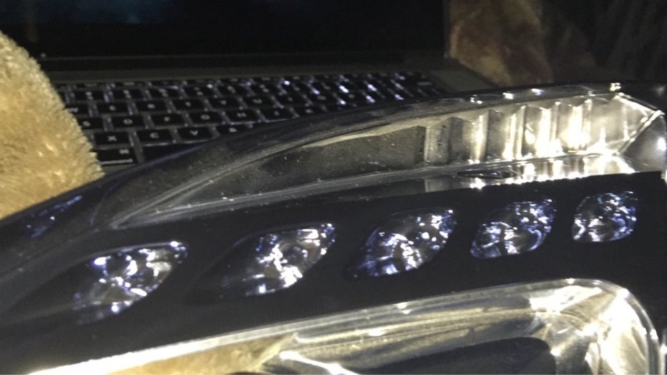

    Sorry for that late update, I just forgot about this thread. Anyways, I had tons of fun working on this all the callous fingers were totally worth it for the end result. took me about a week of downtime, I want to reopen the headlight and get different shrouds not really happy with these, but my options are limited with x lens.
