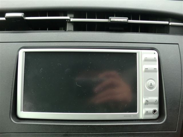

    hi everyone i buy prius which 03 inport form japan , and who have in desbord on tv all japaness languge so pls any one let me know how to change that to english thx

    Now there are two displays, one in the upper dash and the other a flat screen in the console. I suspect the one in the upper dash does not have a lot of Japanese and you can operate the car without a problem. Is the flat screen in the console the one that is giving you trouble?
    Now to answer your question, the language is built-in to the screen. I don't think anyone knows how to change the language once the car is sold. I suspect you will need to find the part from an English language version and have it swapped.
    It would be more useful if you could provide photos of the parts causing the language problem.

    The good news is that you have an NHW11 model, which is much better than NHW10.
    The bad news is that it probably is not possible for you to change the multifunction display from displaying Japanese characters. You could try to purchase a replacement MFD from a salvage yard, from a car originally shipped to an English-speaking country.
    Maybe it will work in your car. Maybe it won't. No guarantees as there may be conflicts with other electronics in the car.
