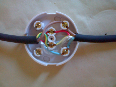

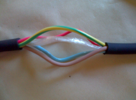

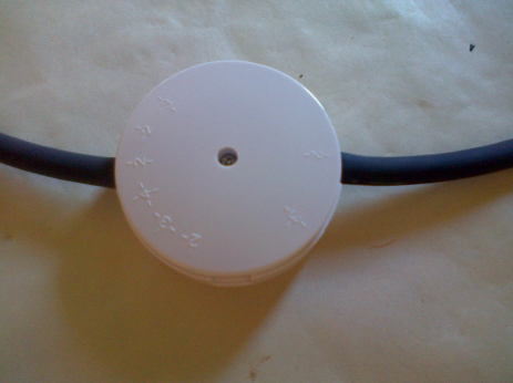

    As part of a project to connect my charging cable to my 240V domestic supply, I need to feed the cable that attaches to the J1772 socket through a brick wall from the carport into my garage. I realised that the easiest way of doinig this would be to cut the charging cable between the J1772 and the Control Unit but I did not know what I would find inside the cable and couold find no specific help on the internet. I was curious as to how many wires would be within the cable and whether they would be colour coded or all the same colour but numbered. I bought a six terminal 20Amp junction box just to be on the safe side and with trepidation cut into the wire. I need not have been concerned - fifteen minutes later all was connected and charging again. I thought I would share a few photos so others could have the benefit of my efforts! (I am not sure what the purpose of the clear strands of polythene-type material running along the cable are - so I left them attached)

    The poly strands are there to add strength to the cord . It takes some of the physical load off the copper wires and outer sheathing.

    The filler-strands are also used to fill the voids between wires, prevent the insulation from wearing through, and to make the cable round.

    The junction box looks interesting. A proper junction box should be rated for the current of the breaker protecting the circuit with 10% to 20% headroom. It should be rated for the expected ~voltage. It should be made from a material that does not burn or melt. and it should provide adequate mechanical protection to protect against accidental contact with the circuit.

    I don't get what you did. It looks like you just inserted the junction box into the middle of the cable without cutting the cable itself (since the poly filler is intact), and I don't see what that accomplished. How could you have put it through the wall?

    Yes you are correct, so far I have not done the drilling of the wall to pass the cable through. I wanted to check that I was not going to have any difficulties with wiring the junction box. I have to fit these projects in piecemeal rather than getting a good run at them. This project is well within my capability but I have day job and a family to raise!
