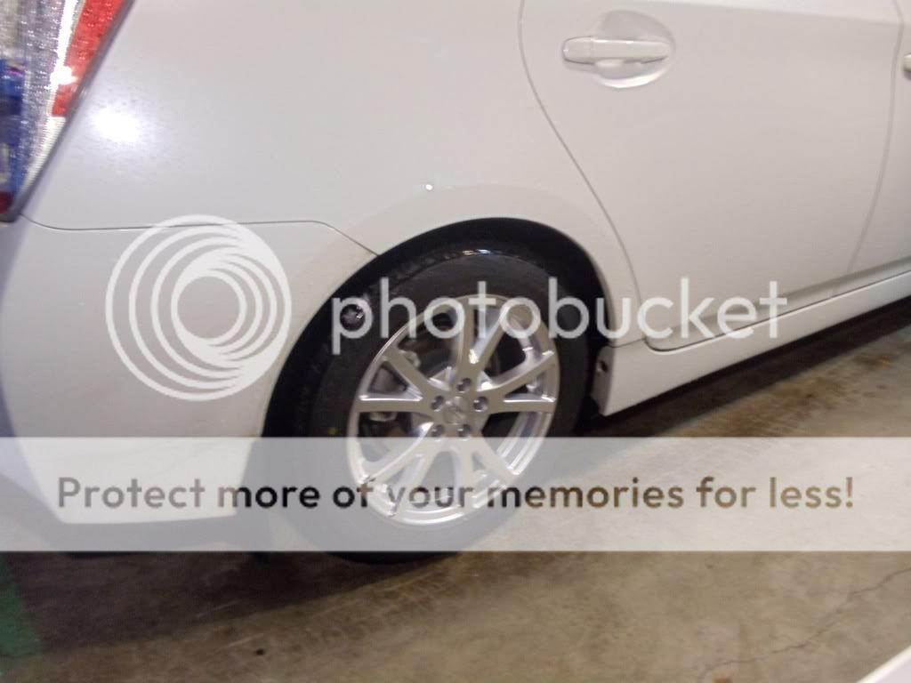

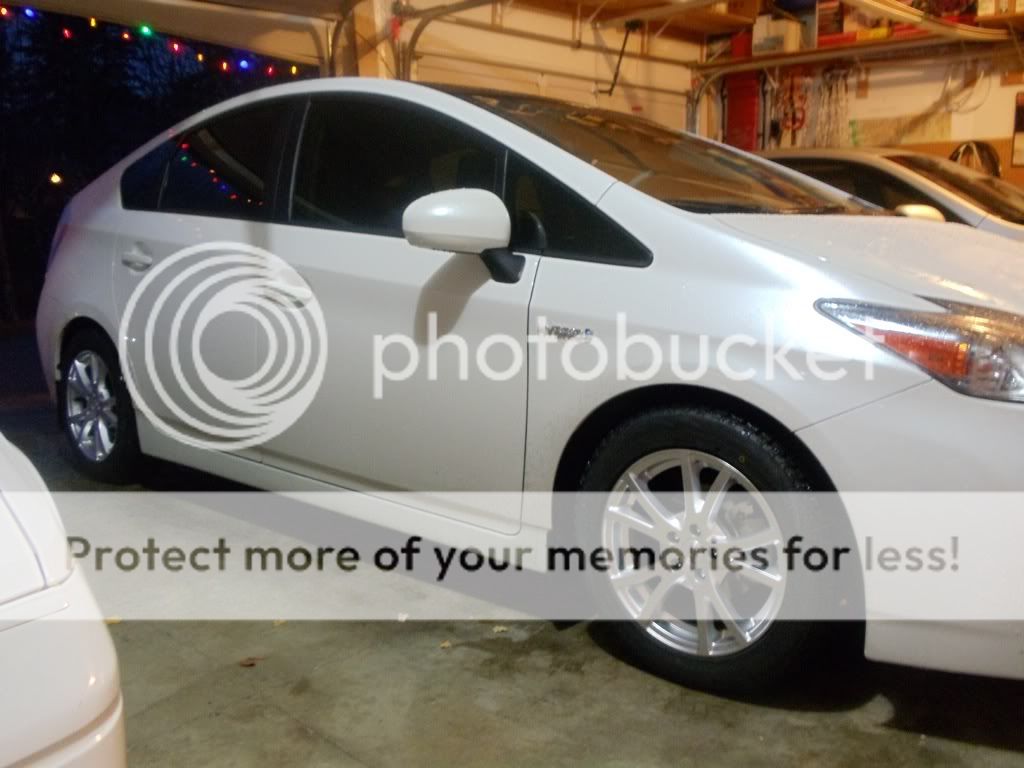

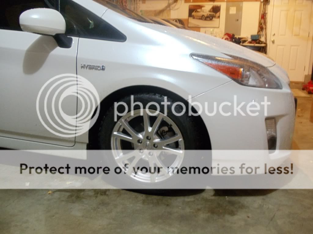

    I got around to installing my Eibach springs on my 10 Prius III. It was pretty straight forward. The fronts were very similar to my 09 Corolla in having to remove the plastic cover & metal tray pan to get to the top of the struts. Pretty easy but tedious. The rears were very simple. I just took out the lower shock bolt & I was able to push on the hub enough to wedge the OEM spring out. The Eibach spring is shorter so it was easier to slip it back in.
    The handling difference is amazing. I also installed my 16" winter wheels & tires that I used on my Matrix so I can see what effect the heavier wheels & tires have on my mpg over the next couple of months.
    Before....
    After....
    Front Eibach vs. OEM....
    Rear Eibach vs. OEM....

    Looks great man! And I like those wheels. I just installed my Eibachs today too. Did you measure before and after height to the fender?

    I thought about it after I had already started. :eek: The drop is only 1.1" according to Eibach but the result of that inch is fantastic. The handling is 10x better from my initial drive.
