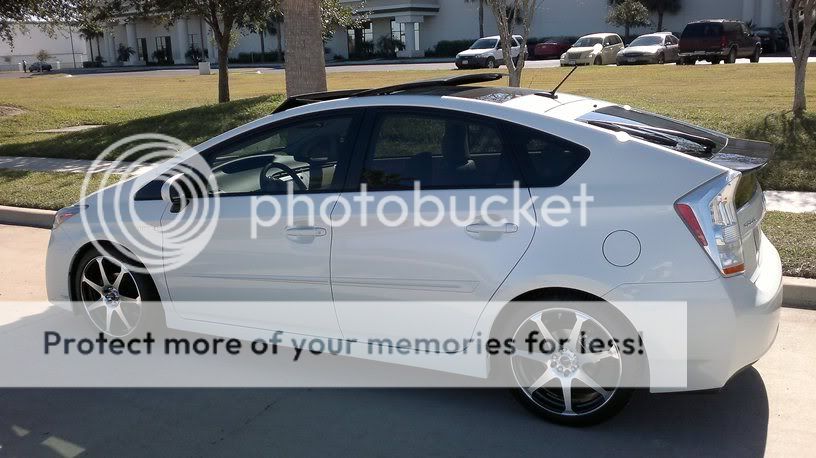

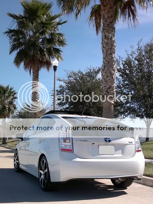

    I finally had time to install my springs yesterday. Like the others, the rear is a breeze, but the front is a bit more time consuming. Eibach states a 1.2" drop in the front and 0.8" in the rear. Based upon my before and after measurements, I dropped 1.0" in the front and 1.0" in the rear. It has a slight rake to the front. It definitely changed the stance of the car and the tires really fit well now into the fenders. Thus far I am loving it!
    Before the Eibach kit:
    After Eibach kit install:

    Looks great! I like the tapered moldings you have better than the standard ones, flow much better with the body line. You should get the smoked Valenti SB lights to go with your rims and solar roof.

    :D Looks really nice... especially the before pic with the rear wiper and gas cap on the wrong side. lol!

    Glad to see you could pick that up...attention to detail! Needed to flip the photo so the before/after shots were similar.

    Wow. Those make a night and day difference on your car. Nice work! Looks great.

    That drop looks like mine! :D Funny how we both did the same thing with our Prius on the same day too! :rockon:
