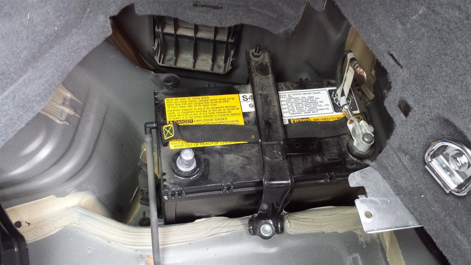

    Need some help here in relation to this issue.
    I too am having the red triangle on startup then goes out straight away.
    Its been cold the last few nights (Winter here in Melb Australia) Under 8 degrees celcius.
    I noticed this light last night and again this morning. If the car is driven warmed up the problem doesnt occur.
    If it sits for a while the light will come on and go out again.
    Is this the 12 volt battery on the way out. I have booked the vehicle to go into the dealership early next week hopefully it holds out till then.
    I am assuming the battery is still the original vehicle was built on the 12/2007.
    Anything else to check or look out for?
    Edit
    Just to add to the above i tried the on of headlight sequence and unable to get into this mode.
    I have been able to in the past.
    When vehicle is set to accesories and once i turn the headlights on i get the red triangle and the MFD screen resets with the Toyota emblem. Everything basically dims down and the mfd reboots.
    I can still start the vehicle it goes into ready mode but the headlights are a bright once in ready and quite dim when i turn the vehicle off.
    I will purchase a replacement battery tomorrow morning and hopefully thats all it is.

    Final update hopefully.
    Today the wife took the car into Toyota requesting a replacement battery even though i had it booked in for Tue. Dealership offered to look at it which was great. They determined the aux battery (small one) is on its last legs hence the issues we are having above. All good so we thought.
    Anyway the wife went into the spare parts dept and asked to purchase one.
    None in stock further checks in their database there are none in Australia dealer advises 4-6week wait. Has to be ordered from Japan.
    Well what a suprise that was i wasn't impressed.
    Great service initially but of all things a battery Australia wide not availiable is on the rediculous side.
    My preference was to go genuine but we had no choice in the end.
    I noticed some people here are using optima batteries google search came in handy i found a distributor here in Melbourne and rang them.
    Distributor just got some in for the Prius. I went and picked one up from the otherside of town after work. (85kms there and back in my thirsty V8)
    Now just need to install it.
    Regards

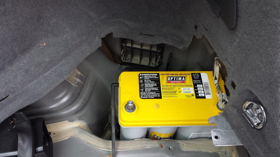

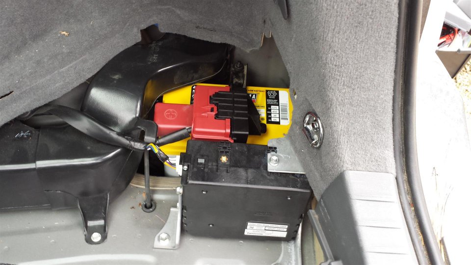

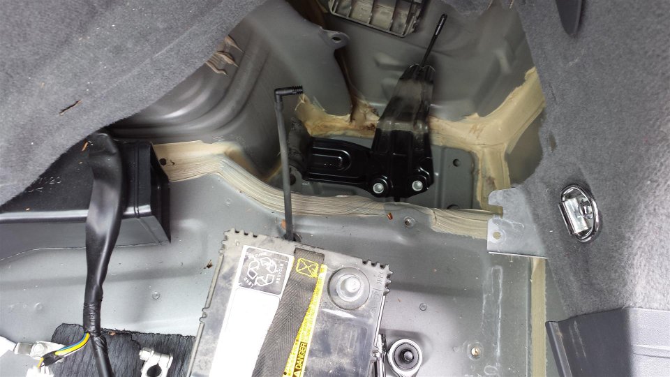

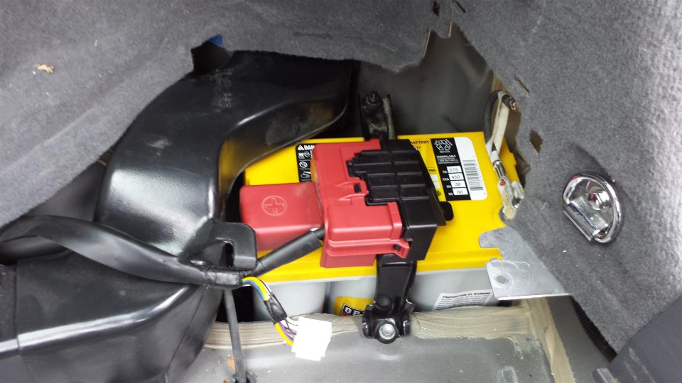

    Your Vehicle Year:
    Installed the optima yellow top battery. All good but i cant believe where they put it from factory.
    What a pain installing it. You have to remove the air duct and everything around it to get it out and back in.
    Well its done now havent seen the red triangle appear since so it looks like its good to go.
