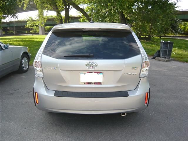

    That is correct. Thanks;

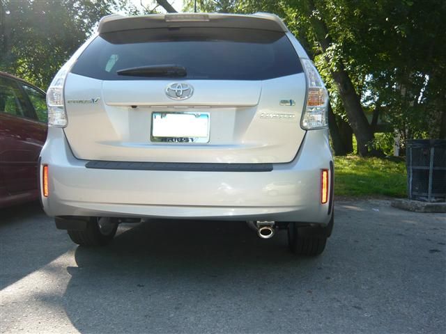

    You appear to have a chrome or stainless exhaust tip. Would you share where you purchased this? Also, do you have any issues with its proximity to the plastic bumper ... i.e. is it getting too hot and melting the bumper?

    See link below:
    Tail pipe tip | PriusChat

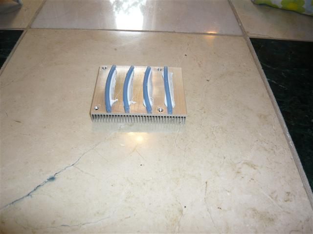

    I have the tip about 1/2 inch away and found no problems so far but a member mentioned that after he got stuck in a traffic for a while his bumper melted! So I added a heat sink just in case below:
    [IMG]
    It is barely visible from behind.
    [IMG]
    No problems so far. :D
