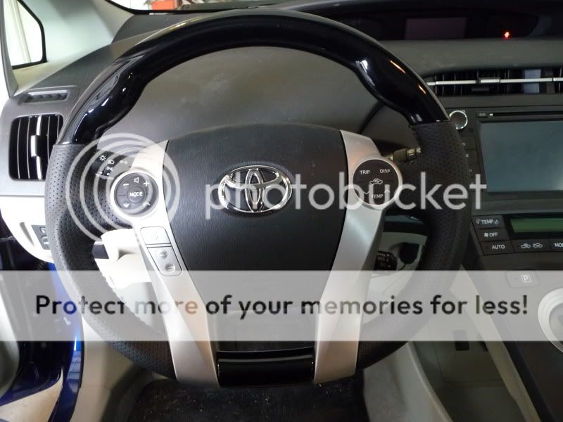

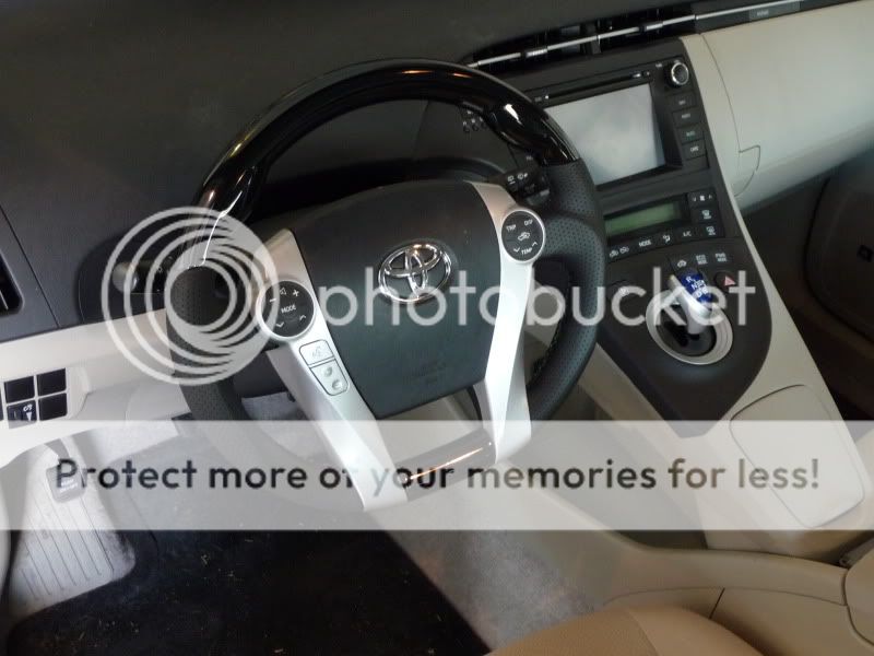

    OK, just installed it, took less than an hour taking my time. Big thanks to W202MAE for the nice DIY write-up. A few notes:
    1) The little yellow tabs on the airbag connectors just pull straight up. Just use a small screw driver to pry them up as shown in W202's write-up.
    2) Once you get the nut off the wheel, it feels as though the steering wheel is not going to budge. I was about to get my wheel puller when I gave it a pretty hard jerk and it popped right off.
    3) I found it interesting that the stock wheel has a vibration dampener at the top. The weight at the top that is held on with 2 screws is mounted in rubber. These are called Tune Mass Dampers and are used to eliminate vibrations and I re-installed it on the new wheel.
    4) The new wheel is a lot heavier.
    5) Getting the plastic back cover off the old wheel is a little tricky. You just pry out the clips at the bottom then pull firmly on the top to remove the unit. The top is held on with a couple of plastic posts that go through holes in the steering wheel and then there is a little plastic tab that holds it in. When you pull out, it straightens out the tab so that the post will pull through the hole.
    6) I looked up the torque for the steering wheel nut, it's 37 foot pounds.
    7) Once I got it all together, I noticed a rubbing sound. It was the back plastic wheel cover rubbing the steering column cover. The plastic cover on the wheel was seated all the way so I just pushed in on the plastic cover on the steering column cover and now there is no more rub.
    8) I got really lucky, my steering wheel still lines up down the road perfectly. No need for a front wheel alignment.
    9) The wheel looks and feels fantastic! Very nice and easy mod.

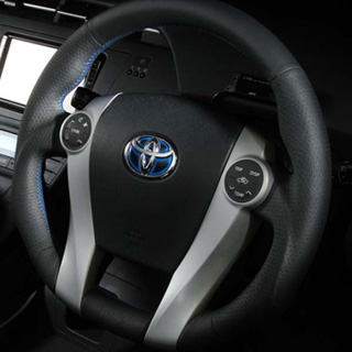

    Also, there apparently are several different types looking at the grip of the sport model. I am looking for the "kuroki or kurogi" eye model which is what I think my co-workers lexus has... like an ash wood.
    Looking at the 4 and 8 o'clock section of the wheels, they all seem different. The first also has leather wrapped nubs at 10 and 2.
