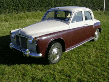

    The other thing was a classic car website. There were a couple of cars that had good bodies and good interiors, but completely knackered engines, transmissions and brakes. One of them was a Rover 110. When I was a kid (in the 80s), my Dad had one of these - in the same colours as the one in the picture below - and I loved it.

    Having experience in restoration of classic sports cars I can only say that be prepared to spend a lot of money north of $100K USD. The Rover 110 and Armstrong Siddley are not desirable classic cars that everyone craves to own, thus the cheap value today. It takes the same amount of labor to restore these cars as well as highly desirable classics like Jaguars and Rolls Royce. The cost of parts may vary due to availability. The other thing is someone has to engineer this powertrain swap so that not only is it functional but safe which means rewiring the whole car to current 12Volt system. There will be periods of trial and error on top of the normal restoration process. The brakes may have to be updated because the Prius engine is several times more powerful than these sedans of yesteryear. (Not too many opportunities to say this. LOL.) You also need someone who you can trust or know someone who can make sure you're not being ripped off every time you sign a new check especially if you are not savvy with what goes on during a restoration.
    So you need a lot of money and patience and understand that when its all finished and done, the car will still be worth close to the original value that you bought it for or less because you have radically changed it from its original configuration. So why would you do this? LOVE! You loved this car as a kid. No one else would understand but there are countless car enthusiasts in the UK that restore hopelessly shot English sedans, pour enormous time, energy and money into it and live happily thereafter.

    Would you need something with an exact match on the wheelbase, or is shortening or lengthening an option? I had a quick look, and there's about 10cm (4") between the wheelbases of a Rover 110 and a Prius or Camry.
