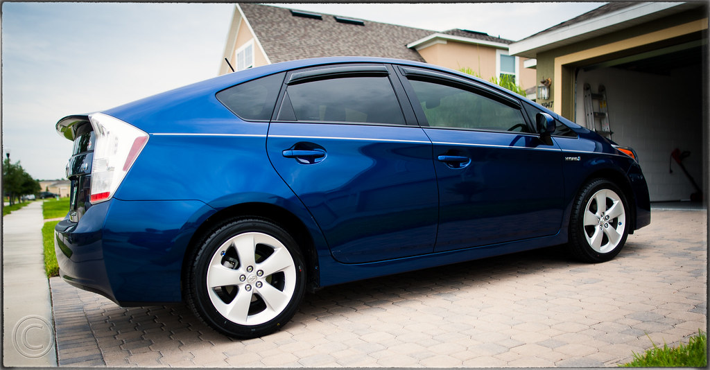

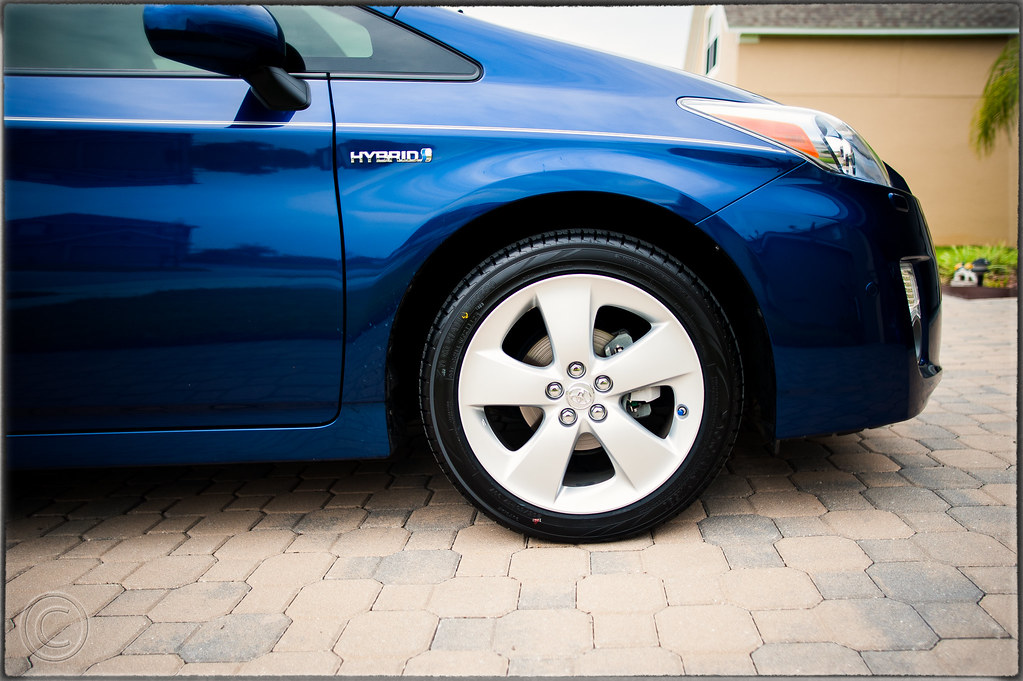

  18. plam0ne
    plam0ne Ninja
    Feb 19, 2012
    70
    florida
    heres some photos of 205.50.17 tires on a prius
    [​IMG][​IMG]
    2 people like this.
