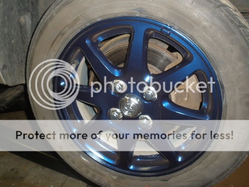

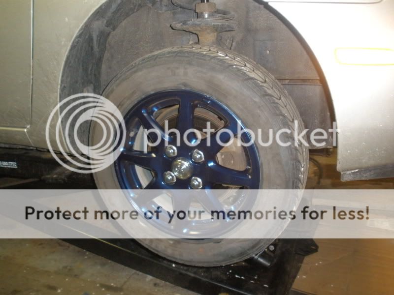

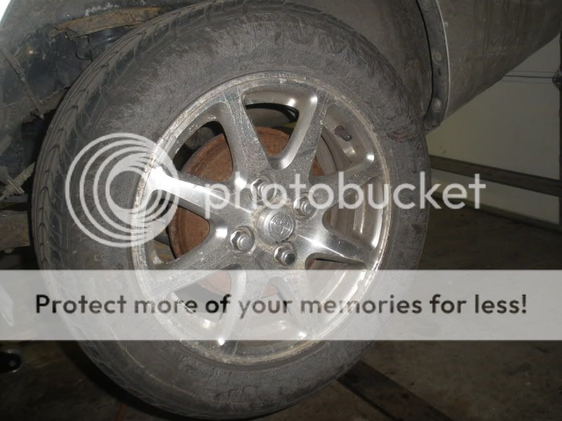

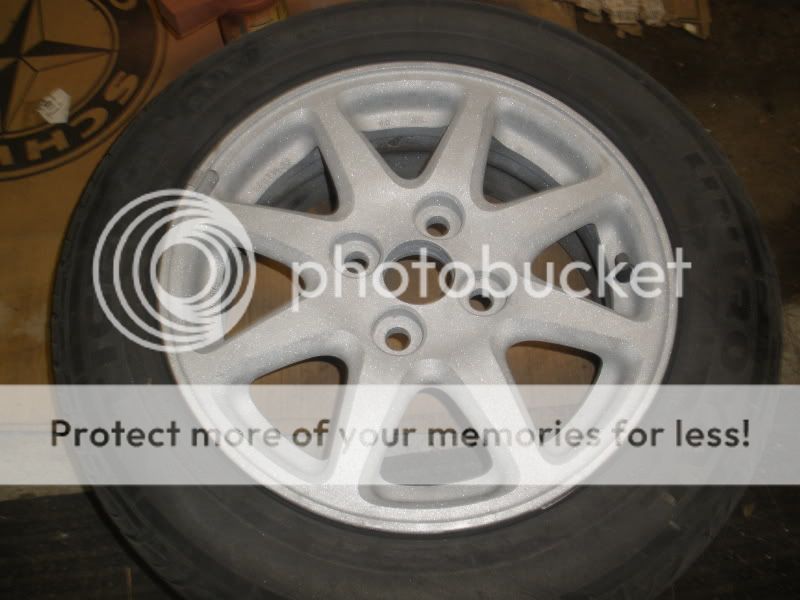

    The wheels on my 01 Prius were hazy and badly pitted. I decided to sandblast them and repaint them. I could have probably had a body shop do the work, or even had them powdercoated, but I did the DIY approach. I sandblasted them and painted them dark blue.
    I have a few photos of the project:
    Wheel before -
    Sandblasted -
    Painted -
    So far I like the contrast of the dark blue against the silver. Makes the car a little unique. :)

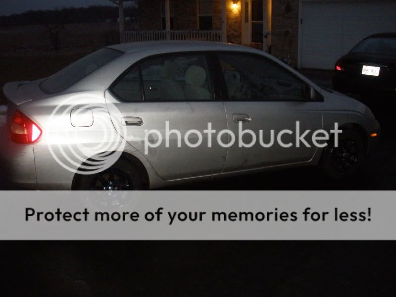

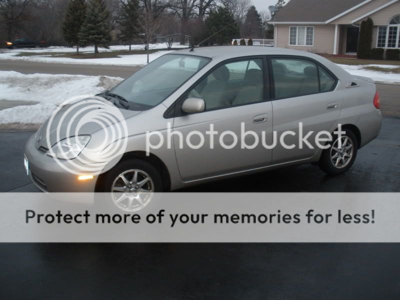

    The whole car needs a clean up after driving the salty roads.
    Before & after shots -
    Photo is a bit dark but...
    Steve

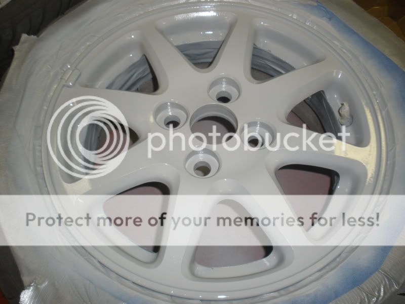

    As far as painting/prep tips: Once the wheels were sandblasted, I taped/masked off the tire around the bead area. Some people have recommended using a large piece of cardboard with a hole in the center that is the size of the wheel diameter. Then you can just set the cardboard over the tire and don't have as much taping to do.
    I followed the tape with 2 coats of automotive primer. Then several coats of the finish color. When that was done and thoroughly dried (at least over night), I applied several coats of clear.

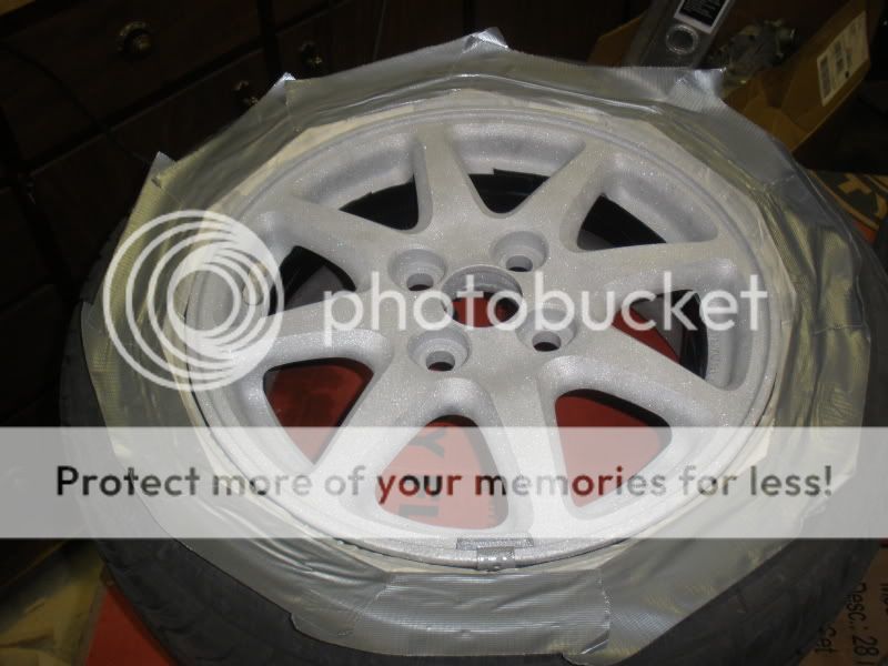

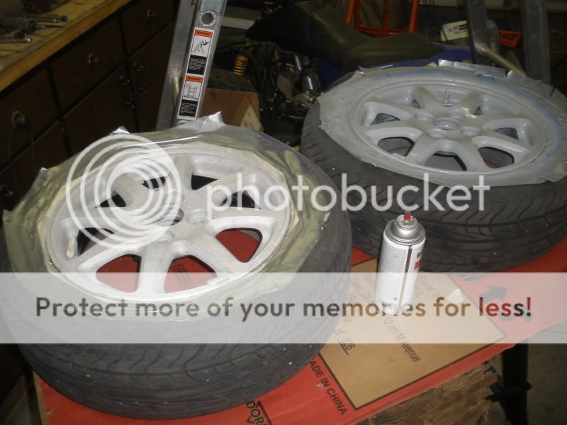

    Just a few more photos of the wheel painting project.
    Sandblasted & taped:
    Wheels getting primered:
    Primer coat:
    Hopefully at some point I can get a good "after" photo when the car is clean.:)
