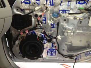

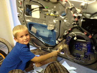

    I found during research and when I deadened my doors that water does get into them and inside the door skin.
    Just FYI in case you want to glue the felt on the outer skin behind the speakers...
    Deadening inside the door skin really helped make the doors seem so much more solid but if you do, then you shouldn't use anything absorbent.
    If cost is an issue, check out FatMat, found it on amazon, $45 for 25' sq, did all 4 doors and seems to hold up great.

    ImageUploadedByTapatalk 21370565755.947576.jpg ImageUploadedByTapatalk 21370565780.718505.jpg
    Pics aren't that great. My little boy liked to help but that pic shows the deadener on the inside of the outer skin. I didn't take a ton when I did it.
