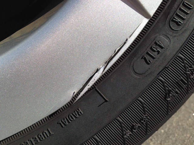

    When I got home and turn the car off then back on for another trip, the tire pressure warning light came back on. I thoroughly inspected all the tires and noticed damage to one of my wheels. I've included a photo and it looks like the plastic has been cut into or somehow fractured.
    I'm not sure how a tire rotation is done or if this damage could occur from that, and was looking for opinions. Of course the dealer denies they had anything to do with it.
    I would really appreciate feedback on both these problems. The wheels and tires otherwise seems okay. The tire pressure is normal, I checked it.
    Thank you experienced Prius owners!
    Also, when I purchased the car in May, used, from this dealer, it came with new tires. I know this damage to the wheel didn't exist then (reviewed my photos,) and even a week ago when I washed and waxed it. To me, it looks like "pinchers" have been used to make two "cuts" in the plastic like material. No way could a 'rock' do this.
    Opinions? Thank you again!

    This is not wheel, this is wheel cover. I bet you or someone curbed the wheel and damaged the tire and thus slow air leak. Been there, done that.

    That would have to be a really sharp curb though. ;) :D
    Curbing a wheel or cover usually results in more damage, and scraping, and definitely not clean cut edges as seen in the picture.
    SCH-I535
    OP, can you see any damage to the sidewall, close to the bead, on this tire, or the other one on the same side of the car?

    The tires actually appear ok, I will recheck tomorrow just to be sure.
    I can't remember the last time I parked next to a curb. Between two driveways, parallel parking at work and shopping, I would have had to do curb parking long before several hand washes... I would think those jagged edges would have caught on my rags and sponges or I would have noticed it.
    Also, if you look at the edges, it's like someone literally cut into the cover. I realize the cover needs to be removed to rotate the tires, and since the warning light and this damage occurred immediately after a tire rotation, I'm strongly suspecting the dealer being the source of the problem. Perhaps that tire has a slow leak, that would be really disappointing if true.... Yikes.

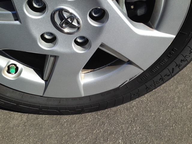

    I don't see any damage to any of the tires, here is a wider view.
    Thank you for your input, I appreciate it!

    If the tires are holding pressure, look in your manual for the procedure to reset the TPMS. Do it when the tires are cold.
    At least you won't be getting the warning light.
    As for the cover, that's cosmetic. The dealer isn't admitting that they caused it, so you're probably not going to get anywhere with them on that.
    If it were mine? I'd take all the covers off and put on centercaps. :cool: You could try mending them by filling it in with some epoxy or something, then touching up with some silver paint.

    To me, those tires and rims don't look OEM for a 2010. It almost looks like you don't have to remove the covers to rotate tires (the lugs are exposed?). Check your tire pressure over a few days to see if that tire is actually losing air. If so, get some soapy water in a cup (dish detergent works well) and use a small fine brush dipping it in the soapy water then gently brushing over the damaged area and look for bubbling. That would shore up your case for dealer damage.

    The dealer may well have damaged the hub cap while rotating the tires, they don't put their best and brightest mechanics on jobs such as that. You could ask them but don't be surprised when they say "oh no, we never do anything like that you must have hit a curb".
    You might pick up a used one on eBay. If it were mine I would just take the other three covers off and toss them.

    It sure doesn't look like curb damage. But to look for wheel/tire damage you need to remove the trim and inspect the entire wheel and tire. The trim could have been replaced with the damaged part in a different position.

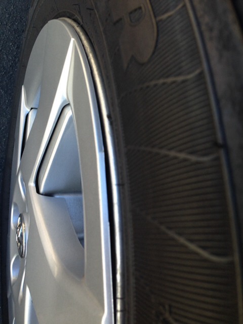

    I've only hand washed it, the dealer might have run it through a car wash during the service, since it came out wet... this new photo includes some other "bending outwards" of the cover, near the "cut" area. (In the photo below, it appears "above" the "cut" area. In the close up photo, its slightly to the bottom.) It almost looks like some device was inserted to pull the cover/rim off and bent it outwards here too. Maybe before the mechanic tried more strongly in the area the cover broke.
    I inspected and took photos of the other wheel covers and wheels, even moving the car to look at all angles. Only this cover shows any sign of separating from the tire/wheel base. The others are all on snug, not bent, not damaged.
    I hadn't thought of a car wash, very interesting thought.

    Here are some additional photos...
    I know I might come across sounding slightly defensive and upset (and I am not very happy about this situation,) but I do appreciate everyone's input and ideas. Thank you again.

    They dropped your wheel cover on the ground. I did that to mine one time. I took the cover off and about to place it on the table. My hand slipped and I dropped it two feet off the ground and it caused the similar damage. From your pictures, it seems like they dropped yours even from higher. I am 99% sure that what happened. Just get a new wheel cover and get it over with. No damage done to your wheel.
