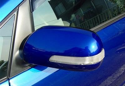

    You can also buy the JDM mirror covers that have the signal in them, but I think there around $400 USD
    Like These.....

    SFV, are those pictures of the JDM headlights or the US headlights with ambers removed?

    They are JDM headlights. :D
    You have 2 choices......you can buy a set of Euro/JDM Prius fenders with the hole in there, or you can cut the hole out yourself.
