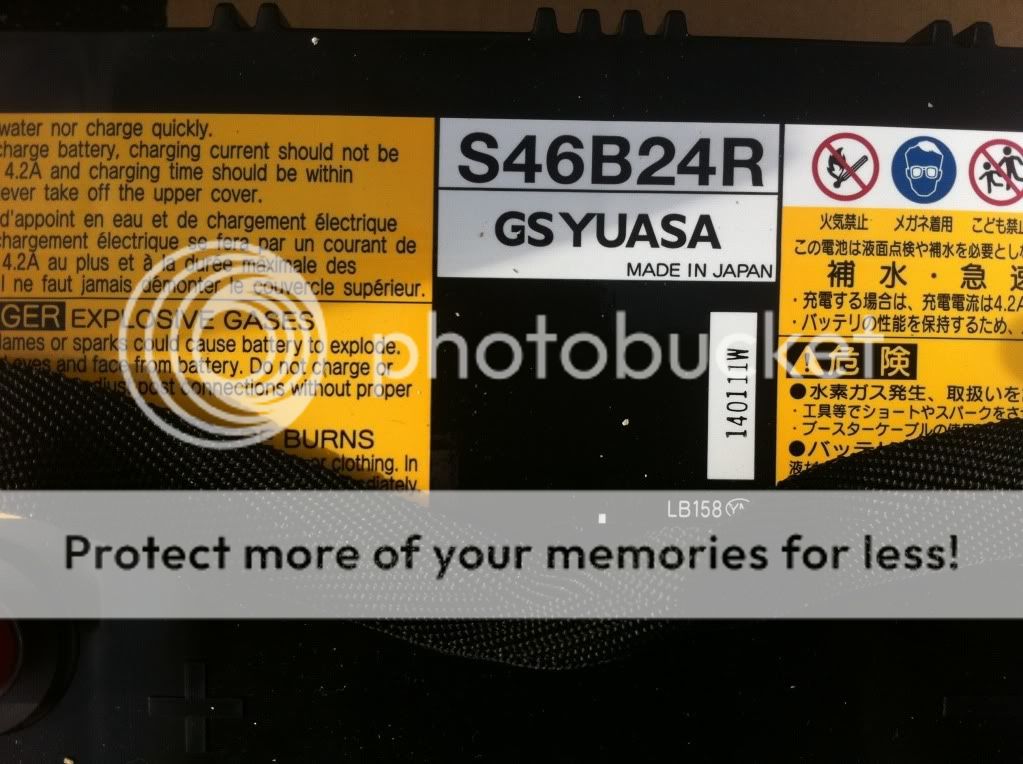

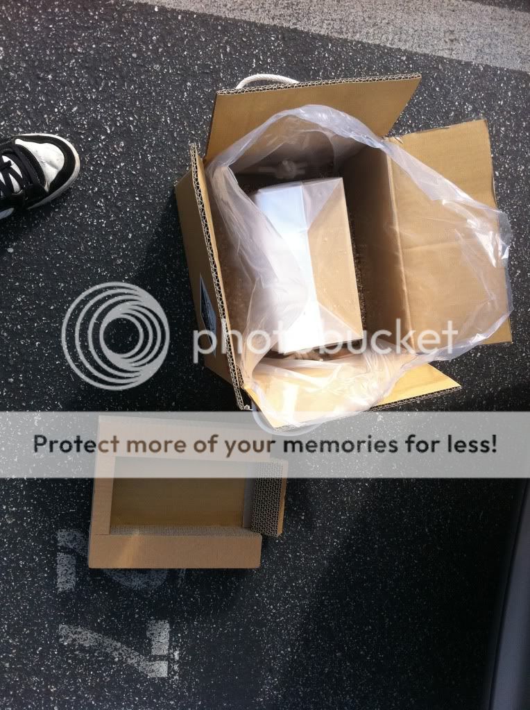

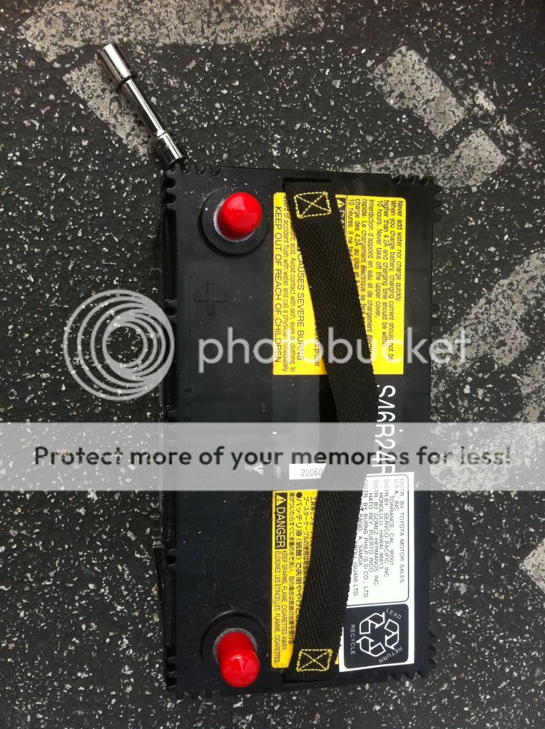

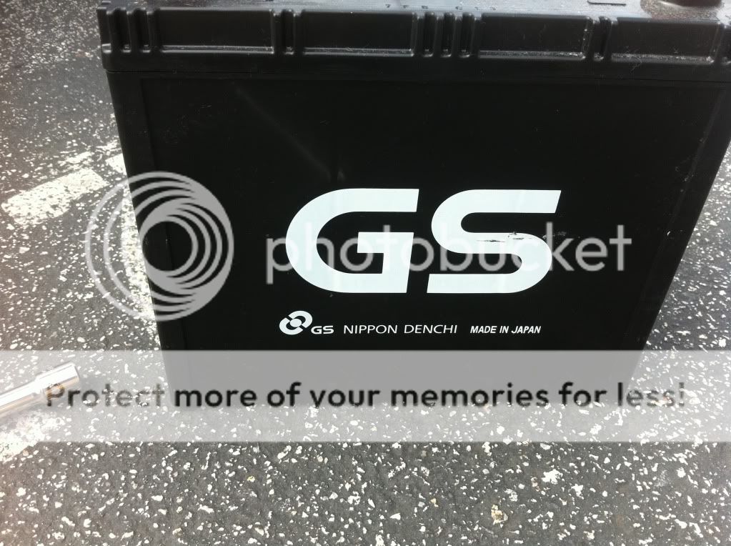

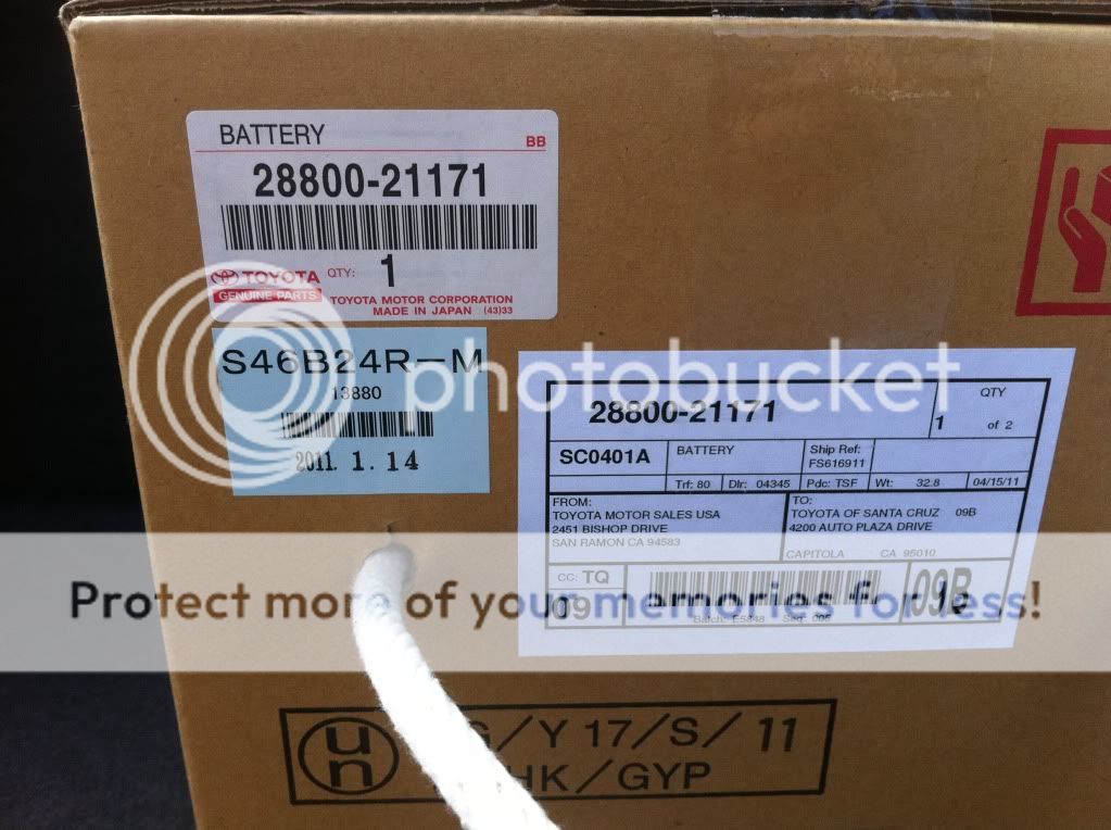

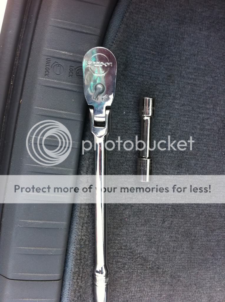

    As promised, here are the pictures of the new battery. The new battery, IIRC, does not have any printing on the sides but otherwise looks similar except for some label changes. The entire job took about 40 minutes and is easily doable by someone who has some mechanical experience. However, I would not recommend this battery replacement to a novice who has never done any work on their car.
    Outside of the box:
    Unpacked:
    Close-up of the new battery:
    Tools need to complete the job-- 80 tooth ratchet, 6" extension, 3" extension, 12mm socket, 10mm socket and a super small flat head:
    Old battery:
    Label on the side of the old battery, I think:

    I'm wondering why a new Toyota part number was assigned. Your new battery has the same GS Yuasa labels and S46B24R model #, as the battery I bought under the old Toyota part number in December 2010.

    Except for the part number, same labels as the battery I bought 3 weeks ago.
