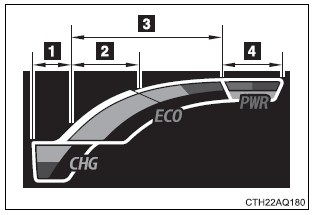

    Hybris System Indicator
    The HSI shows you your power demand, and a good driver who knows the optimum power ranges of the engine can use the HSI to get much better MPG. It also is the best tool for zeroing out the power/regen while coasting.
    So the real time MPG display is a useful way to learn what your demand is doing to the engine, but only if you can see where your power demands fall at the same time. So you need both displays to really learn and maximize your MPG numbers. Without being able to display both at the same time C drivers need to resort to looking at longer term MPG under various driving styles, possibly with the help of a Scanguage...or, of course, to get tips from others who have their own long term experience.

    I really strongly recommend doing some reading about efficiently driving a Prius - there are lots and lots of posts (and YouTube videos) on this topic. Anything that discusses a Gen III (2010-) Liftback or a Prius c or Prius V will talk about the HSI - the Hybrid System Indicator.
    It is also discussed in Section 2-2 of your manual. It appears on both the "ECO Score" and "ECO Savings" (in Basic mode) displays, but has its own page in the manual, where you'll find the above illustration.
    Well, no, that's not right.
    The HSI is your most important tool for knowing where the most important points are for accelerating and braking and for fine tuning your inputs. It's not telling you, nor particularly influenced by, your current "instantaneous" MPG... and that is a good thing if your goal is getting good overall MPG figures. What impresses me most about the HSI is the way Toyota has designed it to succinctly communicate key information about the entire hybrid system in one basic continuum.
    I haven't been posting regularly for awhile, but a video that used to be commonly posted was this one:
    It is for a Gen III Liftback, and the HSI looks slightly different, but the concepts are very similar and can be applied to driving the c.

    They are the same... mostly. The HSI will give you the range up to which your MPGs will start dropping. EG: You are travelling at 50 mph on a flat terrain. If you keep the HSI below the ECO line, your instant mpgs will be 99.9, but if you press the throttle a little bit more it will drop. Knowing where that line is helps out tremendously. Whereas if you were looking at just the mpg in real time, you would only know if you crossed the ECO line by the fact that your mpgs started dropping. HSI is more efficient in this example.

    ... It's called being aware ... As you press the accelerator, the HSI bar moves up towards the ECO line... when you cross the ECO line your MPGs drop ... Even when you are driving over 45 mph, it still works this way ... You should try it, might make you more efficient ...

    The line is significant. Keeping it below the ECO line at the majority of speeds will allow the ICE to disengage.
    ECO is in the middle of the line. There is an entire section that is below "power" and above ECO. I'm telling you, before you argue it further, try it. Drive on a level road (which shouldn't be hard since you live in Florida), drive at 50 MPH. Put your HSI bar just below the ECO line and watch your instant MPGs hit full on the radio screen (you can view this because you have a PC 3 and you will need to hit the car button on your radio). You will drop when you go above the HSI ECO line. This helps you be "clairvoyant" as to when you will be getting bad gas mileage before the instant MPGs tell you that it is going to be so... thus making you more efficient.
    Due to our conversation thus far, I feel the need to tell you to pay attention to traffic foremost and don't do this on a crowded road.
    It's not rocket science. If you know how much pedal you can give the car before the MPGs start dropping, it's going to be better than being reactive.

    The HSI shows the instantaneous power output of the hybrid system (ICE and electric motors). The instantaneous MPG is dependent on the hybrid system power output as well as other factors including road speed (MPH). To maximize fuel mileage, the driver needs to regulate the power output. The instantaneous MPG, which is a secondary parameter, will follow as a result. Therefore, the HSI provides the most direct information for the driver to achieve the best fuel economy, and it is the primary instrument by which the driver controls the hybrid system. My G3 Prius shows the instantaneous MPG on the HSI display where it is always visible to the driver. It is useful to have it there but not necessary to obtain maximum MPG. For whatever reason (cost, space), the Prius C does not display instantaneous MPG on the HSI because it is not as important as the power output. In the lower half of the ECO range, the car is propelled primarily by the electric motors. In the upper half of the ECO range it is propelled primarily by the ICE. The power output is the most important information that the driver needs to know, and it is on the HSI. Based on my understanding of the G3 and Prius C Owner's Manuals, Ztanos is correct.

    Although the bars going up and down may look similar - and they are similar - the HSI has a big difference in that Toyota has taken the most significant pieces of information about the operation of the HSD and disaplyed it to you on one simple graph. They've given you a huge hint about how to run the engine in the most efficient range when it is running, and that's quite different from what you're trying to do with instantaneous MPG.
    Then, for the times when the ICE is off, the instantaneous MPG graph is useless. It shows nothing helpful at all.
    The HSI, meanwhile, is continuing to give you important cues about how to drive your car efficiently in this mode.
