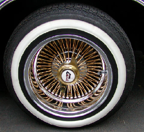

    Personally my next wheels are going to be something along these lines:
    [IMG]
