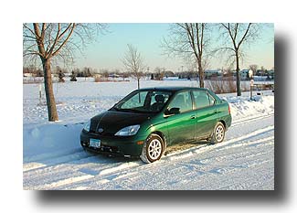

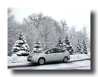

    12 winters driving a Prius in the Minneapolis/St.Paul area, with all 3 generations...
    [IMG]
    [IMG]
    [IMG]
    ...without any trouble. Though with an Iconic model (2004-2009), you should upgrade to a decent all-season tire. The newest (2010-2012) works great with the stock tires. Snow tires haven't been necessary. In fact, I've really enjoyed the seasonal changes with the Prius. It handles the cold and the slower traffic very well.
