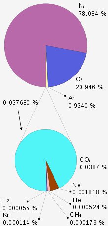

    I believe "Boyles Law" explains it all.
    Standard atmosphere is approx 70% Nitrogen anyway!
    5% rare gasses, the rest O2....
    42 front 40 rear regular air works just fine for me....

    Just to be anal about it.
    2 people like this.
