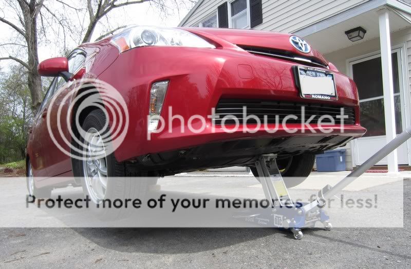

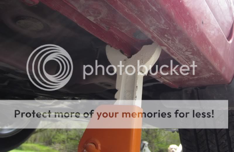

    Jacked up the car - my existing ramps (like these) are too steep, so they hit the bumper before the wheels touch the ramps. :( I'll eventually buy or make new ramps, but for now, it's a jack + stands. Takes a whole extra 2 minutes! :mad:

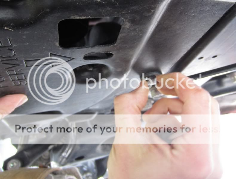

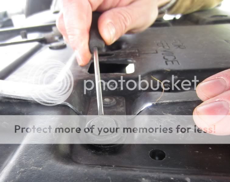

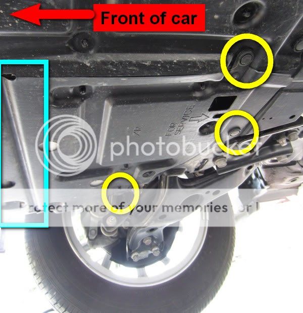

    Here's the access panel: Hinge is in the blue box, annoying plastic fastener pins are circled in yellow.
    Releasing the annoying fastener push pins. Note - I hate the fact that these are intended to be reusable fasteners. Nonsense - they just won't last. I'm working on replacing these - have a few products/solutions in mind. I'll try them out and post back when I figure out something that works better. But for now, you have to release the pins. I like to start with I small screwdriver:
    Once the center portion is out, grasp and pull.
    (To re-insert the fastener, make sure to insert the base with the pin still "out" until the base is firmly seated, then push the pin back in.)

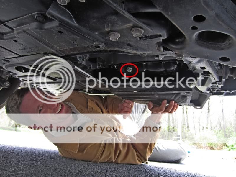

    Panel open; oil drain plug circled in red. Note that I'm holding the panel open - this springy plastic hinge is another annoying "feature" that I intend to change soon.

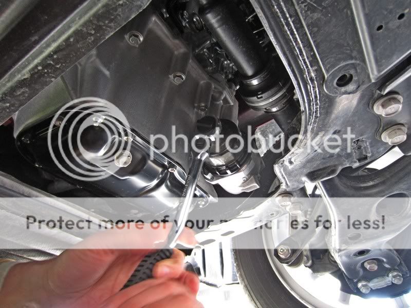

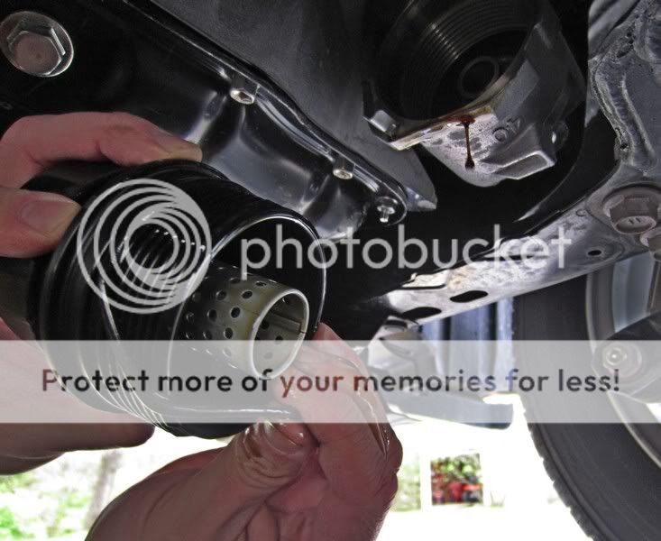

    But we now have access to the oil change parts. In the picture below, I've attached a cup-style filter wrench and a ratchet. My filter wrench is something like a black-colored version of this one, but based on recommendations on this forum, there should be Assenmacher or Lisle brand wrenches that will fit. I believe it's 64mm or 65mm. My wrench fits so tight that I just leave it attached to the filter housing.

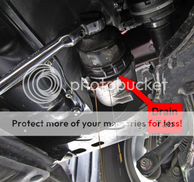

    Once you unscrew the filter housing a few turns, oil will slowly flow out, theoretically starting near the tabs that stick out on either side of the filter housing.
    I let it drain a bit, spin it another 180 degrees, let it drain a little more, until I pull it out all the way. Draining it slowly like this slightly reduces the potential for mess.
    If you are doing a full oil change, you can unscrew the drain plug and drain the main pan either before or after you change the filter. I plan to install a Fumoto valve (F103S) when I do my full oil change - this adds convenience and significantly reduces the chance of spills/splashes/messes.

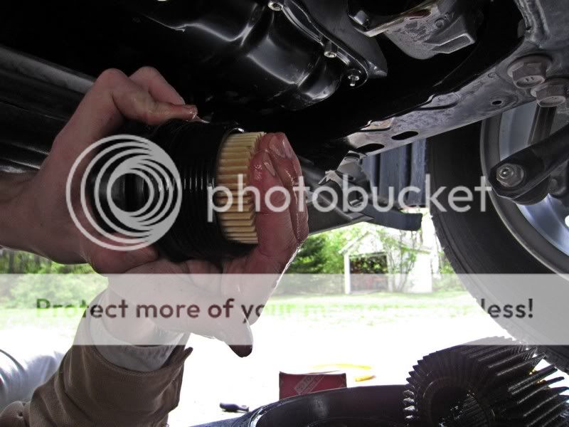

    Back to the filter - next you need to pop out the old filter, and remove the O-ring from the filter housing.
    New filters will come with O-rings, so just stretch the new O-ring over the housing and make sure it's seated in the same groove. If it's not already oily from your hands, spread a little bit of cleanish oil around the O-ring to create a good seal.
    Press the new filter into the housing - be sure it "snaps" in.
    Then just re-install the filter cover (I snug it until the shoulder of the filter housing hits the flat surface, then give it another ~1/8 turn). Re-install the oil drain plug if necessary, add new oil, and you're good to go!

    Sorry to dredge up the old thread, but I received a PM about this, and wanted to report back. I thought I had posted something about this already, but couldn't find it. Anyway, I installed the Fumoto F103S shortly after I posted this thread, and just like the ones I've used with other vehicles, it works great. Maybe even better on the Prius, because the plastic panel door protects the whole thing so debris can't catch on the lever and accidentally open it. (On vehicles where the oil valve is exposed, I just wrap a chunk of 12ga copper wire tightly under the valve; this prevents it from opening).
    I keep a ~8" piece of rubber hose with my oil changing gear - just slip that over the end of the valve, open the lever, and let it drain. The oil does drain significantly more slowly than it would without the valve, so be sure your engine is warm before starting, or just be patient! We're talking maybe 10 minutes to drain, not hours - just enough time to refill the WW fluid, collect the new oil, etc.
    I do recommend this on the Prius - the only thing is that the extended oil change intervals mean I don't get to use it very often! ;)
