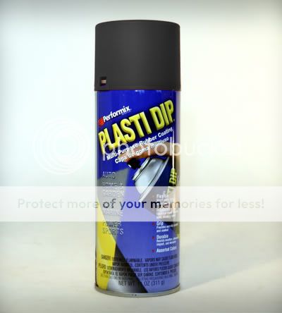

    I have a silver C2 and I am thinking of doing the middle section of the front bumper. I know a few others have used PD before, just looking for some tips!
    [IMG]

    I hope you are getting the Plasti-dip that has the UV inhibitor in it. They make their Colors with, Good, and without UV inhibitor, Bad! With out the UV inhibitor, your efforts will fade and look kinda bad in about 10 months or so. I got a can of red, I had to call the company and speak with a sales man to glean this little tidbit of knowledge! Be sure you buy the UV add spray!

    Hmm. I don't think mine has UV inhibitor in it. I will have to check the store to see what they carry.

    Give Plasti-Dip a call, ask for sales, tell them you are looking for a (What ever you want) color, with UV inhibitors, they will look it up and give you the paint number to look for!
