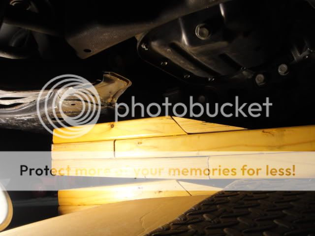

    I have been using jack stands bought from Sears and home made wood ramps:
    [IMG]
    [IMG]
    If the car is on the wood ramps, I put the jack stands under the side railing and the engine as backup. If the car is on the jack stands, I put the wood ramps under the engine as back up:
    [IMG]
    This setup seems plenty safe for me to crawl under the car but my wife still thinks everything will fail and I will be crushed under the car. Is there any chance to convince her otherwise? If so, how?
    Or is it indeed dangerous as she thinks? :eek: I heard cinder block (or concrete?) can disintegrate in an instant but could 3 layers of 2X10 wood split simultaneously all of a sudden? Or can the weld point of the jack stand fail all of a sudden?

    I don't think all of it will disintegrate at once. But, same with wearing seat belts. Most of the time, everything will be ok. When it doesn't.. <ouch>!
    Just make sure you don't do this when you are alone. :)

    I use Rhino ramps on the front and jack stands in the back if I am raising the entire car. Wood ramps with 2X10 should be just as safe as the Rhino ramps.
    If I use the jack stands I usually keep the hydraulic jack just below the jacking point after resting on jack stands for backup.
    One guy carries a tool box or something thicker than he is under the car so that if it does fall for any reason it will not crush him. Not a bad idea.
    I am not sure what else it will take to convince your wife it is safe though :)

    Since you have both the wood ramps and jackstands available, that is the logical equivalent of wearing a belt and suspenders to keep your pants up, and that should be quite safe.
    I use jackstands supplemented by my hydraulic floor jack located at the corner of the car that I happen to be at.
    The Prius weighs ~2,900 lb so the weight at one wheel is < 800 lb. Also, if you have all tires mounted, that will limit the downwards travel of the car.
    If your wife is concerned then that should give her a reason to check on you frequently, bring a beer and/or snack periodically, etc.

    Wooden ramps won't crush like concrete blocks, but they can split. Wood will split along the grain, or lengthwise for your ramps. Distributed loading is not likely to cause splitting, so tires are okay, but point loading under a metal bracket could cause trouble.
    If you want to be extra safe, laminate a layer of plywood into the stack; this will provide cross grain support. For maximum safety, use several thin layers of plywood distributed through the stack. For example, a thin layer at the top, bottom, and in the middle.

    I made my ramps with plywood and 4X4s, and drove a much heavier tractor up on them first, just to be sure. One addition I would make to your ramps is a stop on the end, because going off the end would spoil your day.

    As most above have noted, it looks safe. Maybe ramp up the car, give it a slight shake to see how really sturdy it is. When you are really confident, get your wife, give her the demonstration!

    Your ramps and methods both seem sound. I would only suggest a stop be placed at the front so you could not drive off the ramps as easily. I can tell you that wooden ramps are quite common in the bus/motor coach RV conversion world, like the one currently in my avatar.
