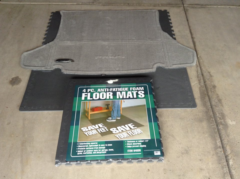

    After you have the 4 plastic egg crates and 17" x 48" piece of 3/16th inch plywood prepared for extending the floor so that you can sleep in the back of a Prius, you might want to consider a closed-cell foam pad for more comfort. Start by purchasing two sets of "Anti-Fatigue Foam Floor Mats" from Harbor Freight (on sale in August for $10 each set). Each set has 4 roughly 2' x 2' squares that have interlocking edges. Put the first set together and then lay the original Prius carpet floor mat over them, aligning the edge of the carpet toward the rear seat back with the top interlocking edge. Using the carpet floor mat as a pattern, trace around it with chalk or white soap to mark the outline. That step is represented in the attached picture. Using a utility knife, cut around the outline and you have a foam mat that almost perfectly fits the cargo area when the rear seat is raised. (If you stop here you will have a nice cargo area foam mat for $10.)

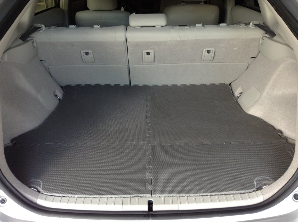

    Step 1 finished: the cargo-area mat has been cut out and installed with the rear seat in its normal upright position. image.jpg

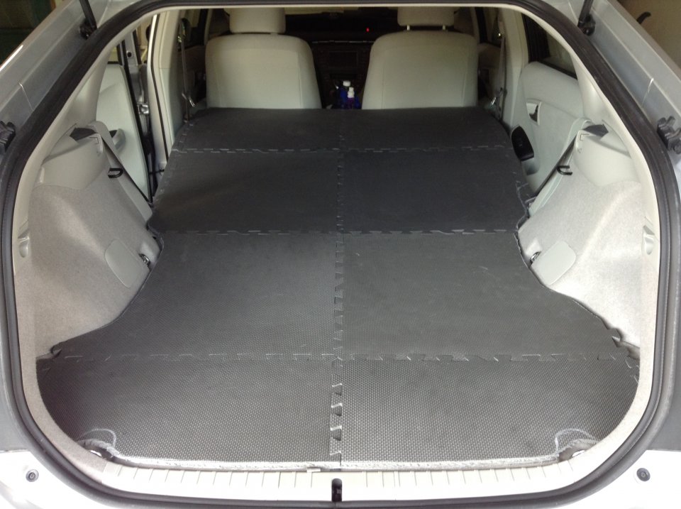

    Step 2 finished: after trimming the two rear corners and trimming away the excess length of the newly-installed set of four mats, the result is an interlocked foam mat reaches from the rear edge of the cargo area to the backs of the front seats. this extended mat can be used as a sleeping pad while camping in the Prius Recreational Vehicle! image.jpg
