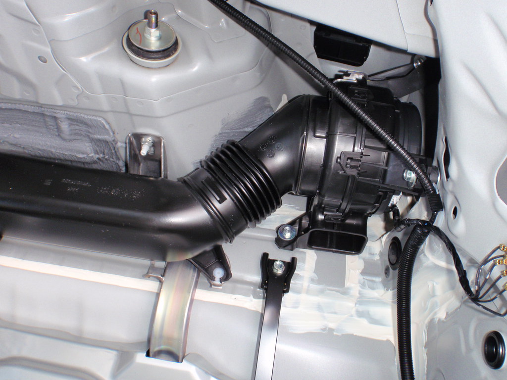

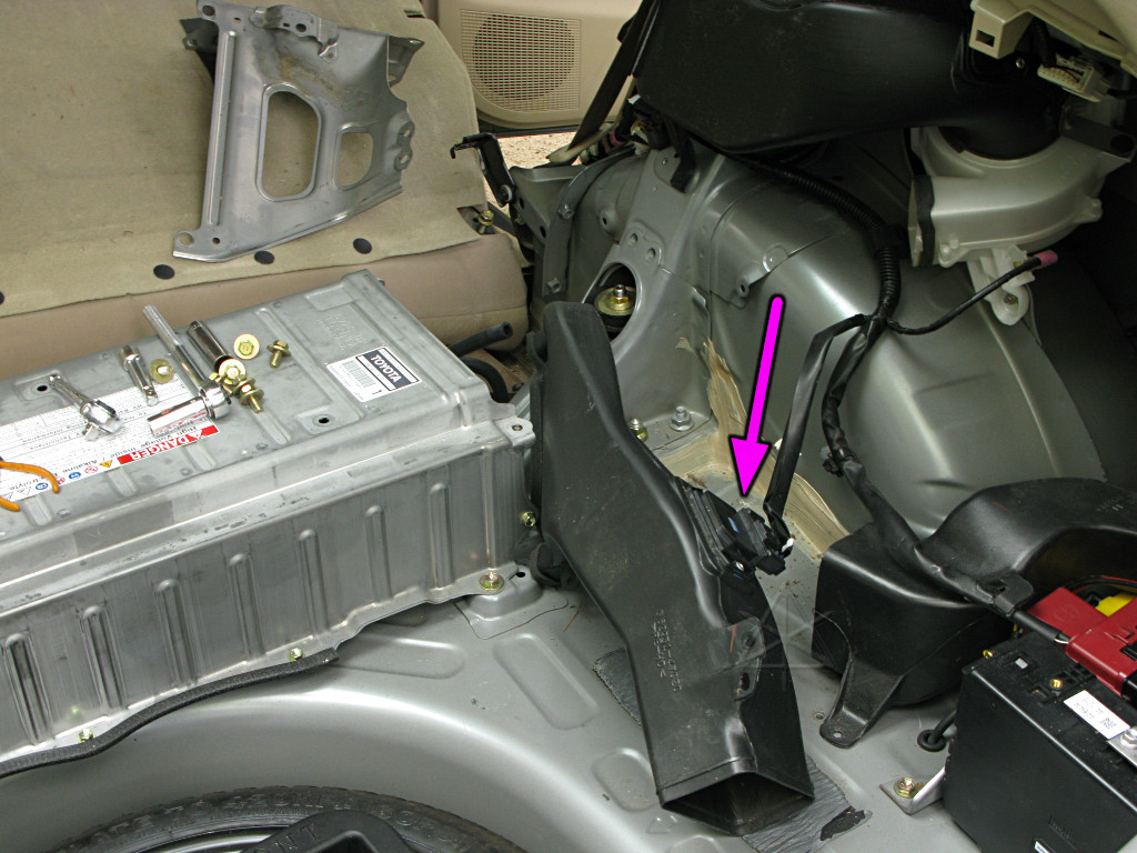

    I am surprised that there is no air vent to cool the battery. In general there is a special vent integrated within the rear window or bumper. Here is a picture of a Prius
    [IMG]
    There is a white fan on the top right:
    [IMG]

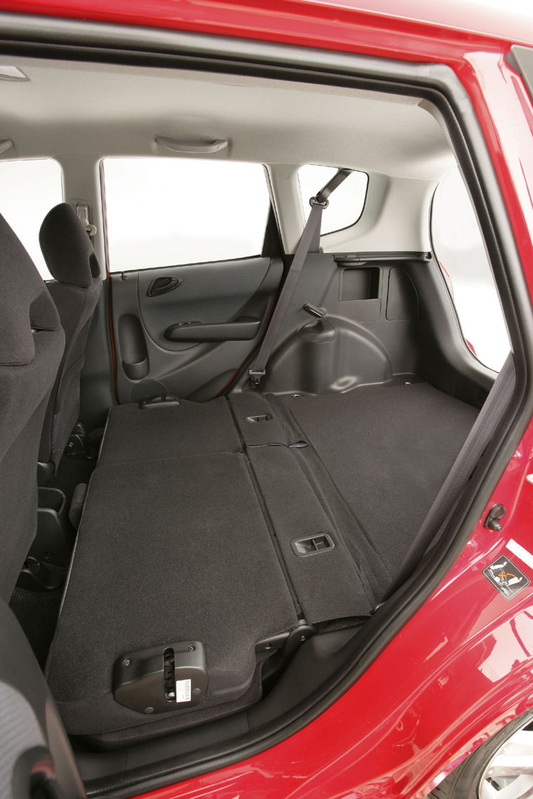

    The Honda Fit back seats can fold up
    [IMG]
    [IMG]
    Or they can fold down:
    [IMG]

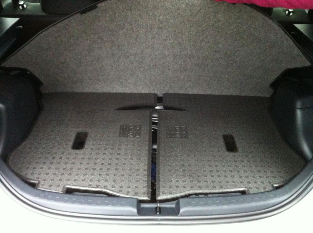

    I was thinking that the back seat was covering the battery, and part of the battery was inside the seat.
    In fact the battery is located well below the back seat, so I don't see any reason to have the bottom of the seat been fixed?
    If you look at the video showing the body frame of the Prius C at the 24:34 to 24:56 time:
    Toyota Prius C Technical Presentation - Dave Lee w/ Q&A
    You can notice that the battery is bolted on the floor panel and there is a metal frame on top of the battery (see Red color in the picture shown in the video.)
    Because of that, there is this "strange" piece of foam, about 7" thick, in the trunk to make the trunk at the same level than the back seat when folded.
    [IMG]
    At least Toyota could had designed a box like in the Prius to store some small items.
    The piece of foam is a waist of space and real no no!
    It looks like an afterthought for a car using such advanced hybrid technology?

    I was told that the foam pieces are for sound insulation.
