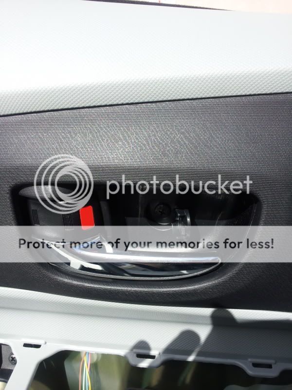

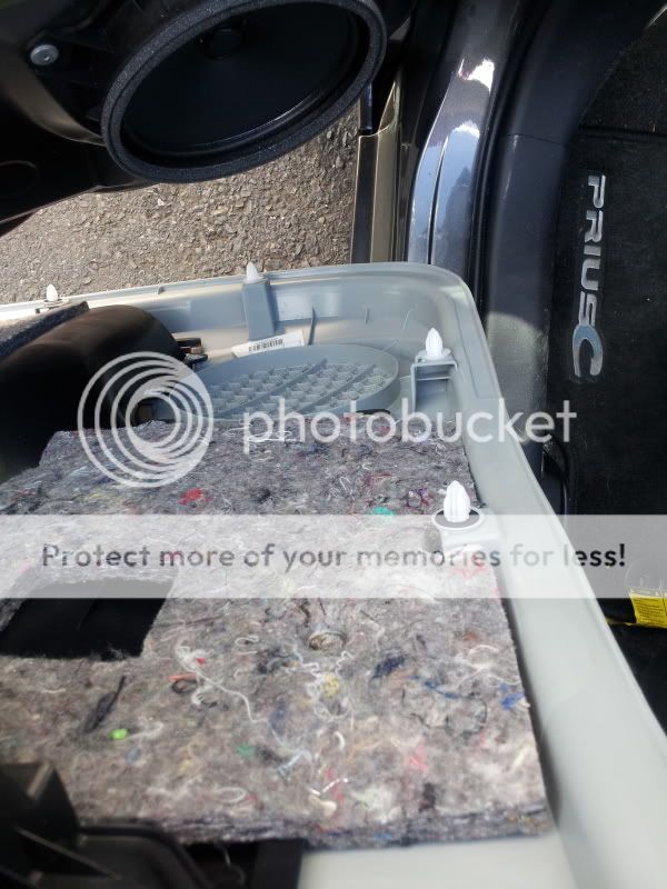

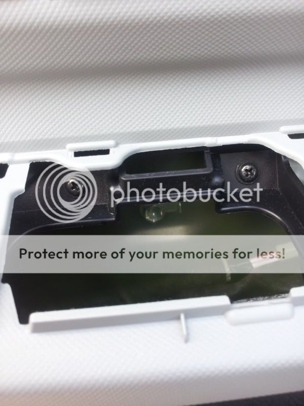

    Well I took my panel off and they look to be 6.5". But they do look as though they need adapters to be able to screw the after market speakers into the door. I'll upload a pic when I get home. Door panel was very simple to get off.

    heres a pic of the front drivers side speaker...i also took some quick pics of the door panel removal process if anyones interested....

    It was actually pretty simple. Easier then my Tacoma. Here's what I did.
    First u take a screw driver and unscrew the screw by the door handle.
    Then take something thin like a a plastic trim remover or in this case I used a thin pear knife and gently run it under the window switch panel lifting up gently to pop it out of the holes its snapped into
    Then u disconnect the white switch cord ( I didn't do that cause I was just peeking behind)
    Next you'll see two screws u need to unscrew where the window switch was
    Once u do that if u feel at the bottom of the panel there are small gaps to either stick ur fingers under or something again flat and just start pulling the panel toward u. Once the first snap pops out the rest come easily. Just work ur way around the door. Once those are popped out u just simply lift the door panel upward to remove it completely
    Here's the snaps and inside the panel side of the door
    Its very easy actually. Just be gentle so u don't scratch the panel :)
