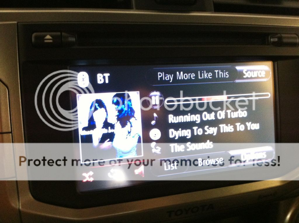

    Here is my iphone 4 (w/ iOS5) bluetooth synced to the base Entune unit in a '12 4Runner.
    [IMG]
    The screen is a little washed out because it was dark. It looked a good bit better in person.

    I think you are missing the point that bkman is pointing out. You are using the Rav4 head unit, which isn't the same as the head unit in Prius v 3 or 5 ATP.

    I had album art when I connected my iPhone 4 to a Prius v during a test drive. I don't remember if I was in a Two or a Three but I clearly remember the album art. I should have snapped a pic.

    I don't recall being able to browse music over the bluetooth. If you look at the picture I took, "more like this" and "browse" appear to be grayed out where you cannot select them. (BT iPhone 4, no tethering plan)
