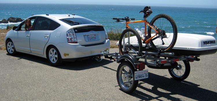

    I know a guy who's done it - and has lived to tell about it so far.
    Curt hitch:
    [IMG]
    Yakima:
    [IMG]
    Saris:
    [IMG]
    Trailer:
    [IMG]

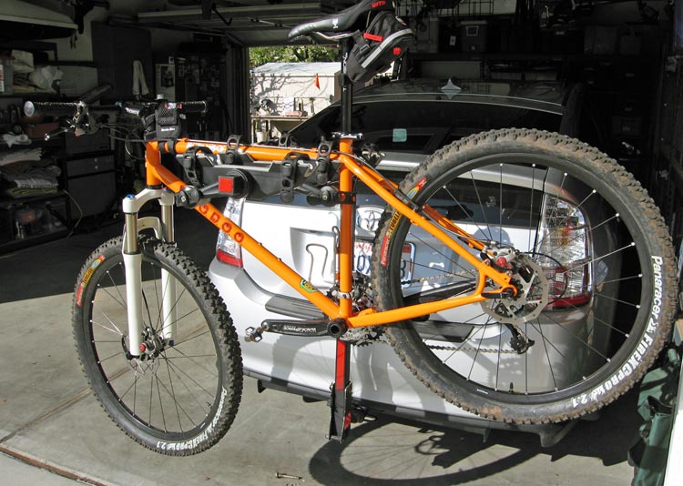

    No problem... expand the thumbnails below for a better look.
    I had a buddy weld another piece onto the Coastal 2" hitch to beef it up and make it a three point connected receiver. It has had a LOT of use and abuse and I've had no problems to date. I installed the wiring kit also and you'll see I keep the plug stashed IN the vehicle unless it's in use. Wisconsin winter road salt is hell on equipment, but my electrical stuff still looks like new. I plan to remove, clean-up, repaint and reinstall the hitch every Spring. (BTW, I had no trouble ordering from Coastal Tech. I've got their EV mod installed also)
    The last pic shows my US Mail Carrier Prius transformed into it's "Aquacar" mode! ;) (Hint: Look close at the hitch)
