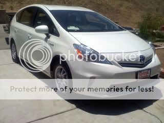

    Well Im back, and this time with a new V. A wopping 91 miles on the clock and more mods planned than miles (y)

    Car was fun, but once I heard the new prius had 4 wheel disk brakes, more HP, and a power button I had to get it.
    The V was an obvious choice for a man with 2 kids. The extra room is nice and a sacrifice in weight and MPG did not discourage me.

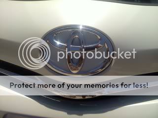

    First modification was to remove the horrid hub caps and flip/remove the blue emblem backings.

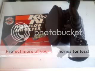

    Then I removed the stock air silencer and made a custom cold air intake pipe. I really didnt like the HOT air intakes that are on the market. Combined with a K&N panel filter, this thing is ganna kick butt.

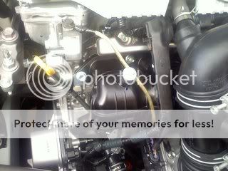

    Did some free mods this morning.
    Throttle body coolant bypass and added a grounding strap to the throttle body to increase throttle response.
    [IMG]

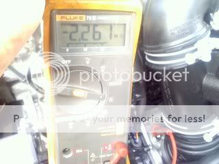

    Stock throttle body sits on a "plastic" intake manifold isolating it from any form of chassis grounds.
    [IMG]
    Once the ground strap was installed the meter showed less than .3 ohms.
    [IMG]
    Thottle response increased over stock. In power mode it feels as if the throttle body is cable driven : )

    You are correct, any aftermarket intake might through a code. The computer should compensate and bring fuel trims back in line. A code being thrown depends on if the computer reaches its threshold.
    The modifications performed to this intake system utilized the factory air box. The factory intake elbow and silencer were ditched for a straight pipe that flows cold air from the fender. Theory is to increase airflow and bring in dense air without altering the way the stock MAF sensor reads.
    After the Maf sensor I have a ported throttle body, to reduce restrictions . The coolant lines were removed to keep the intake air cold.

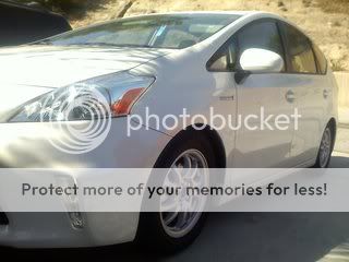

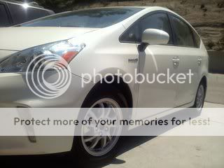

    Well for those who have been following.... ITS FINALLY LOWERED!
    Thanks again to my friends at B&G suspension for hooking it up with a custom one off set of S2 springs. I am really not to sure if these will be in production, but I am sure if there is a demand there will be a supply.
    Car handles so much better. Less body roll, less dive, less squating = Awesome.
    These springs lowered the car 1.5in front and back.
    [IMG]
    Hello. Can you explain how you got rid of the blue? Thanks.

    Sorry for late response. Just pull the tabs in back of the bumper and flip the plastic backing. You'll need to make a couple of new holes but no biggy.

    It removes any possible throttle delays due to voltage inconsistencies. The Tb is not properly grounded and this allows for smooth crisp response. The coolant bypass mod keeps the throttle body and incoming air cooler. Cooler air=dense air

    Much like the electronic throttle controllers that are available...many used in JDM cars...just cheaper?
