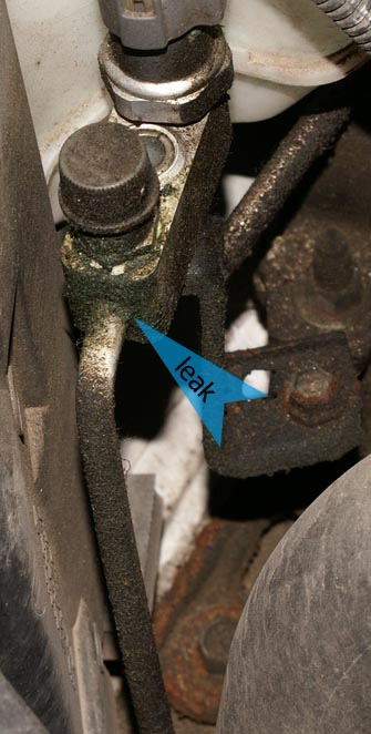

    Here is the location of the leak. It looks like a lot of oil, but when I wiped it with my finger, it was actually pretty dry. The green color is from where the previous owner used leak detection dye (another no-no).
    [IMG]

    Stop being such a tight arse and go get it fixed properly.
    The oil would have mostly blown away in a mist so if you leave it unrepaired you will stuff the compressor, that will be real cheap to fix, not.
    That is saying nothing about the refrigerant you are spewing into the air.
    This isn't some junk yard get about car, surely it is worth looking after?

    you sure the leak isn't coming from that fitting above and not the welded joint? that's a fairly easy repair. do you have the glasses and uv light to detect the leak since the dye is already in there? spray the oil off with a solvent based cleaner, then run the a/c while looking with the uv light. will tell you for sure.
    refrigerant is a gas- it won't leave a residue. that is oil all over the place there. that oil lost needs to be replenished if you want your compressor to be properly lubricated.

    The leak looks pretty bad, and I agree with the other posters that the sooner you can allocate funds to repair it, the better off the AC system will be.
