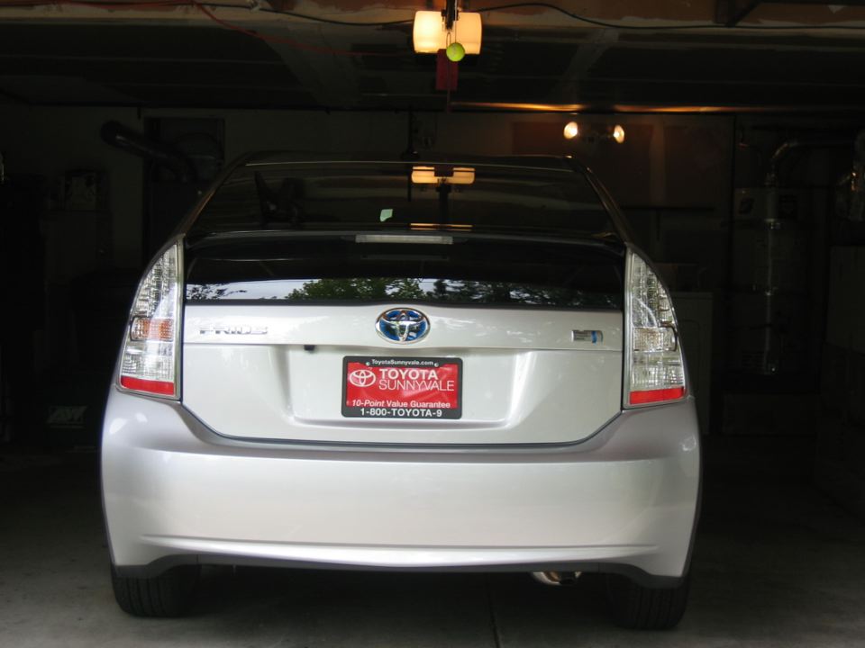

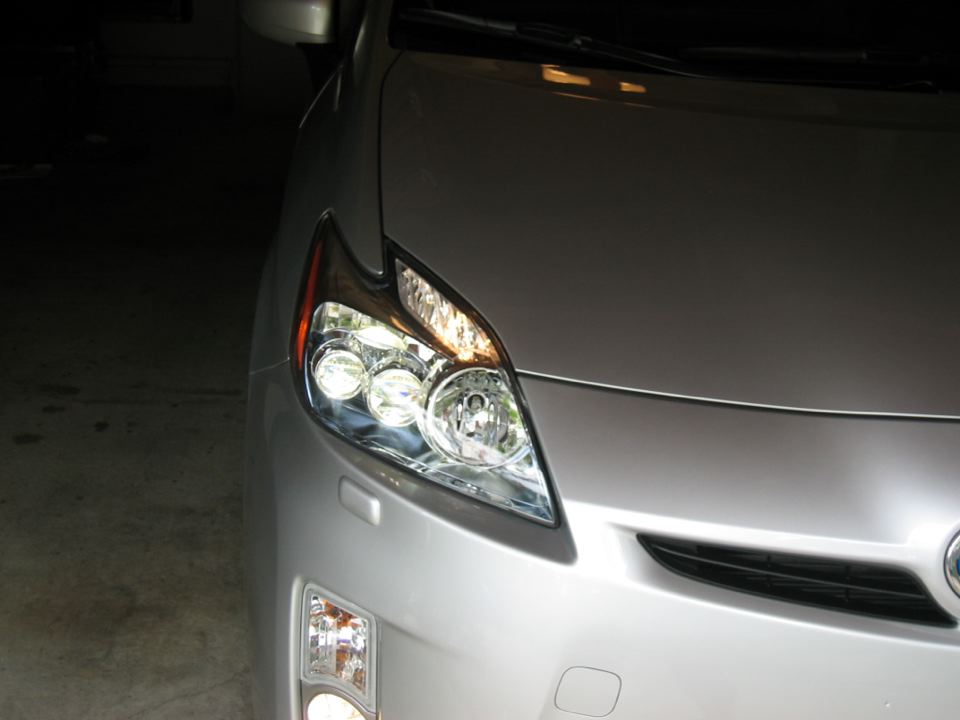

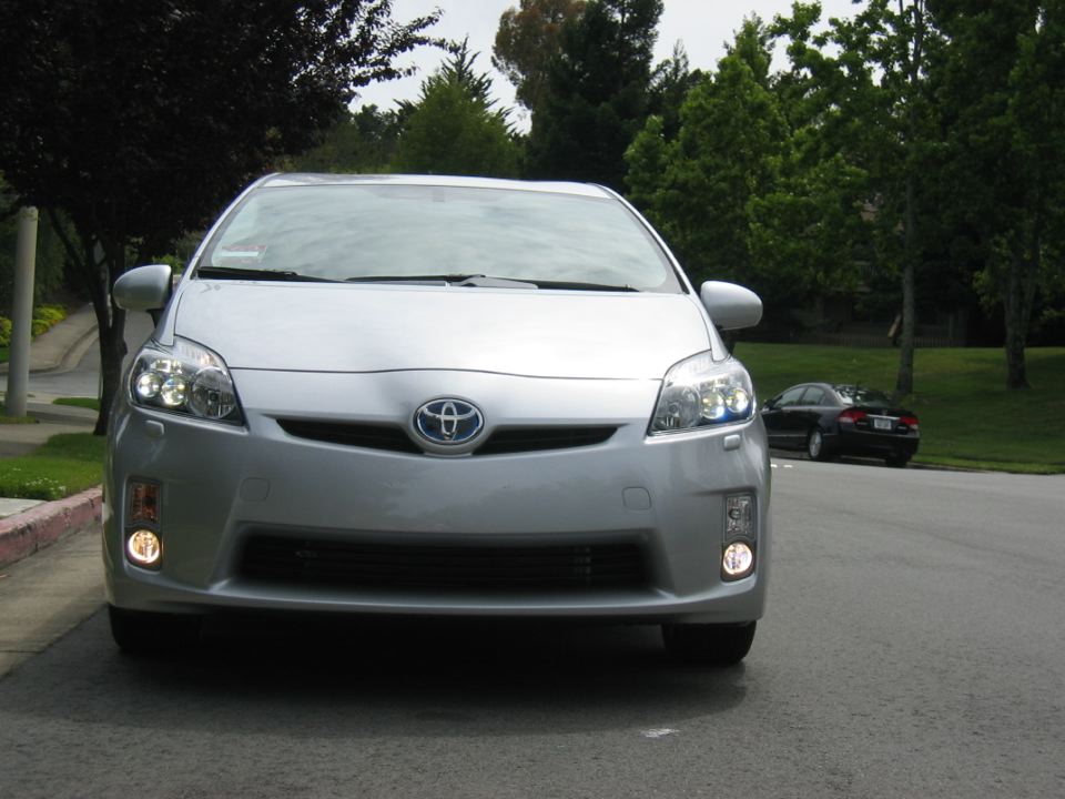

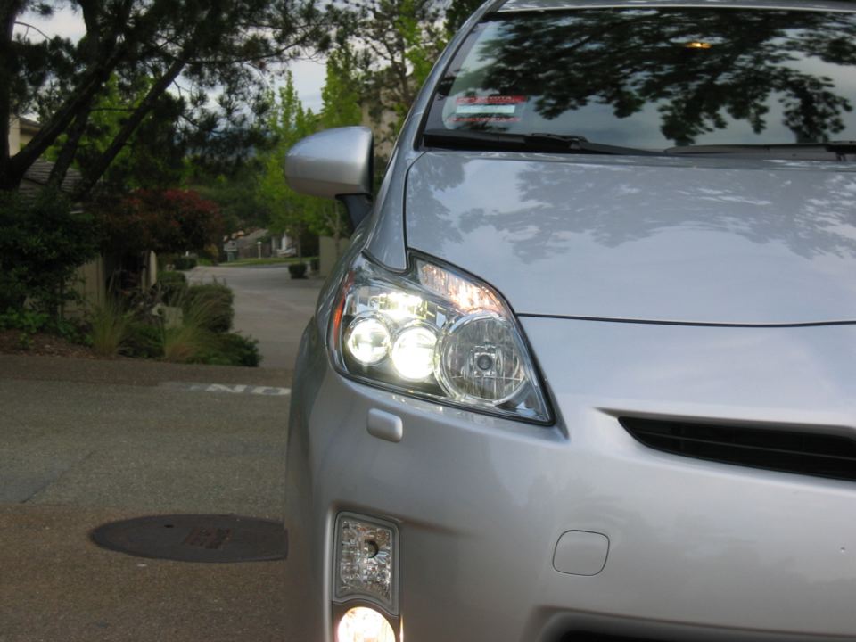

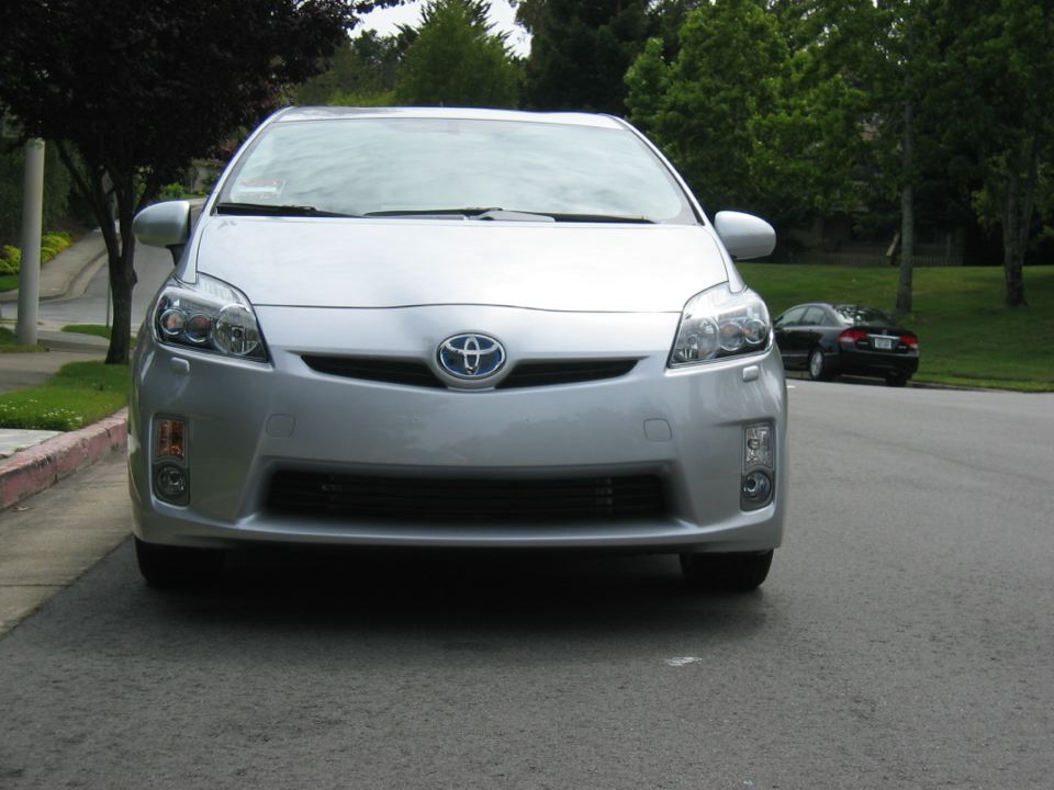

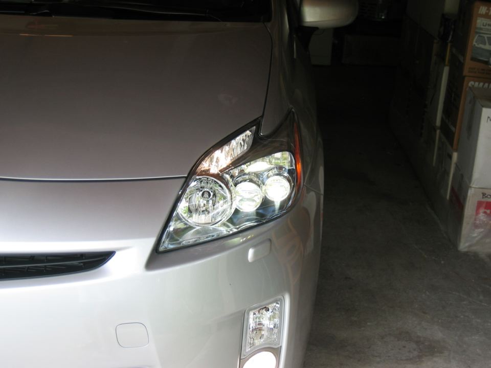

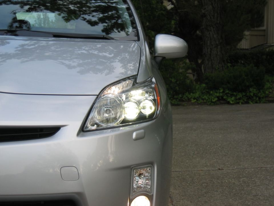

    I upgraded most of the exterior lights (except the LED headlights) on my Prius today. I've used these brands/types of bulbs on many previous cars with great results. For the pix below, I left the stock bulbs on the passenger side to contrast with the upgraded bulbs on the driver's side. Bulb types and replacement instructions are in the owners manual.
    Front and rear turn signals replaced with Philips Silver Vision bulbs, which are silver coated so you don't get the "fried egg" look, but still blink amber. There are other silver coated blinker bulbs on the market, but what I like about the Silver Visions is they blink just as bright as stock, unlike one brand I bought years ago, which blinked so dimly the other cars would have a hard time seeing them, especially in bright sunlight. Got them from Powerbulbs.com:
    Philips Silver Vision WY21W from Power Bulbs | Free Worldwide Delivery
    Fog lights replaced with PIAA Xtreme White bulbs, which are 4000K and match the LED headlights very well, and have a whiter light than the stock bulbs, and are noticeably brighter, providing 110 watts of light using 55 watts (the difference in color is more pronounced than the pix show):
    PIAA 15211 H11 Style Xtreme White 55=110-Watt Bulb - Twin Pack : Amazon.com : Automotive
    High beam bulbs replaced with PIAA Intense White bulbs, which are 4100K and again match the LED headlights very well, and have a whiter light than the stock bulbs (I wasn't successful in getting pix that were worthwhile, but there is a big difference in color). Not only are the high beams whiter in color, they are noticeably brighter as well. According to PIAA, the bulbs provide 120 watts of light using 60 watts--more info here:
    PIAA:
    PIAA 10925 9005 (HB3) Intense White - 9005 60W=120W Xtra Intense White Bulb, Twin Pack : Amazon.com : Automotive
    For the front parking lights and rear license plate lights, I used Philips Blue Vision bulbs, which are 3400K (again, it was difficult to capture the true difference in color, but the upgraded bulbs are a much closer match with the LED headlights than the yellowish stock bulbs). You get a set free from Powerbulbs.com with any order over 15 GBP:
    Philips Blue Vision W5W from Power Bulbs | Free Worldwide Delivery

    Good question--I agree with you about light quality, and forgot to mention this aspect of the replacement bulbs. Not only are the high beams whiter in color, they are noticeably brighter as well. According to PIAA, the bulbs provide 120 watts of light using 60 watts--more info here:
    PIAA
    The fog bulbs are also noticeably brighter, providing 110 watts of light using 55 watts.

    Ok, here are some pics of the front and rear turn signal lights lit with Philips Silver Vision bulbs and more of the Blue Vision for the front parking lights and rear license plate lights.
    8 people like this.

    I think you'd agree that the pix (yours and mine) don't do justice to the color and brightness difference of the front parking lights with the Blue Vision bulbs. Before upgrading, the parking lights looked really yellow next to the LED headlights (and given their proximity to the headlights and the fact that they're always on when the lights are on, the difference really detracted from the attractiveness), and the Blue Vision bulbs, while not nearly the same color/brightness, are much closer to the LEDs.

    Oh yeah, without a doubt... Pictures do not accurately show the difference between the Blue Visions and the stock bulbs. I wish I had taken a picture of the rear license plate bulbs before changing them out, but I doubt they looked anything like what is shown in the pic I put up on the prev page...
