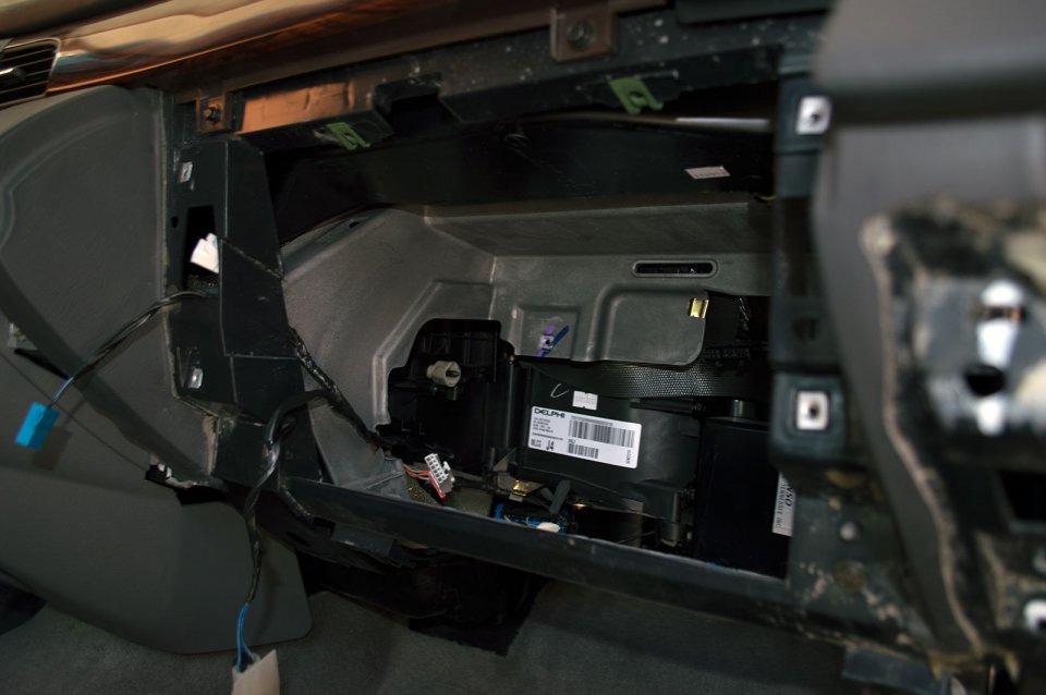

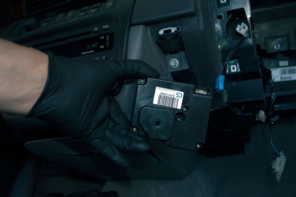

    Here's an example of this type of setup. This is an old 2004 Cadillac DeVille, HVAC Control module for the rear A/C temperature control door. It mounts on the HVAC case, inside the dash and controls a door inside the case that adjusts the output temperature to the rear A/C outlets. The system is a climate controlled setup with 3 zones. Driver, passenger and rear seat zones. All the inputs function through the main HVAC control head. The rear seat has it's own zone controller.
    The system is governed by the IMP control module. IPM stands for Instrument panel module.
    It's the main control that interfaces with the HVAC control module and between them, they make the system function using a Class 2 data network. They are self diagnostic capable and will communicate with a scan tool over the class 2 data network. If the system detects a fault, it will store a code that can be read with the scan tool. The scan tool has bi-directional control over the systems and can also calibrate the temperature doors for the controllers. Without calibration, the system won't function and will store fault codes. Here's an image of the temperature door control module that was needed to fix this vehicles HVAC system. After replacement, it's necessary to calibrate it so the HVAC control module will know it's door location in relation to it's outlet temperature reading. Nothing in today's computerized cars is as simple as you think. Everything is now being computer controlled.
