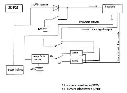

    For anyone who was looking to do same idea with camera selecting, the below is what I'm likely going to do this coming weekend. I get extremely lost if I don't have something visual to follow so I made this once I read joecwilson's post.
    The camera override switch I'm planning on using is this guy:
    Mit Toyota Lexus Scion Reverse Parking Sensor Special Switch Control | eBay
    and DPDT switch is this guy:
    5pcs DPDT No Off No Forward Stop Reverse 3 P 15 30A 6 Pins Boat Rocker Switch | eBay
    Utilizing this relay and 16pin adapter kit from this listing:
    Back Up Camera Video Adapter Harness for Toyota Subaru Scion Plug and Play | eBay
    Fwd camera
    Car Rearview Back Up Camera CCD 170 Angle Wateproof Reversing Camera for Ford | eBay
    Rear camera
    Car Rear View Reverse Backup Camera IR Night Vision 170° for 2012 Toyota Prius | eBay
    I used the various "install your own camera" threads on this forum to find the appropriate pins on my PC2, with corolla radio. If I'm blatantly overlooking something with the above, please feel free to point it out and let me know.
