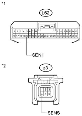

    I don't have the c Repair Manual, but I suppose it is similar to the 2010 Gen3 Repair Manual. Here is the connectors taken from the Gen 3 Repair Manual:
    *1 is the Certification ECU connector
    *2 is the Front Door Outside Handle Assembly connector
    z3-1 is for Locking sensor and z3-4 is for Touch sensor (unlocking). It is highly likely that z3-4 came loose.
    Vincent

    I took the door apart and unplugged what I believe was the connector and then put it back in, and checked all the other wires I could see. I put the aux battery back together and tested things out and so far it's working! I'll see what happens. But thanks!
