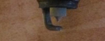

    I don't see anything wrong with the Denso SK16R11 plugs except that they show a rust stain on the porcelain insulator, which indicates some water is leaking into the spark plug wells. This is not the fault of the plugs.

    They look fine except for the rust marks on the porcelain insulators. Check for water dripping through near the cowling under the wipers, several people have reported ingress of water here. If you have the car parked in some heavy rain, or straight after you've been through a car wash etc, then take a quick look at that little recessed trough area in the rocker cover (where the igniters are). You might find you're getting water puddling in there.
    BTW. I'm guessing from the amount of rust staining that the plugs are shown in your picture with #1 plug on the right hand side and #4 plug on the left. Number 1 plug (closest to the pulley belt end) seems to be where the water accumulates most.
    As for the condition of the plugs in general, you need to look at the "business end" to evaluate what's going on. Take a look at the zoomed in area (taken from your pic, 2nd from left) below. Really it's still very good. The electrodes show little to no wear, and the insulator shows only a light grey coating, which is actually what it's supposed to look like. :)
