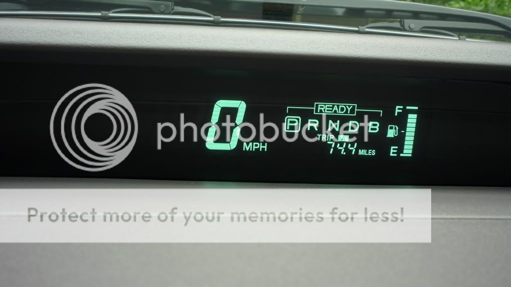

    Lovin' my Prius, perfect shape.... but gee willikers the speedo bubbles! It's the only thing bugging me about this wonderful car.
    What can I do to eliminate this pesky problem.
    I have seen other Prii on eBay with the same thing.

    Nope.... Not on outside. Bubbles are behind the plexiglas. Can this piece be taken out of speedo cluster and fixed/replaced?

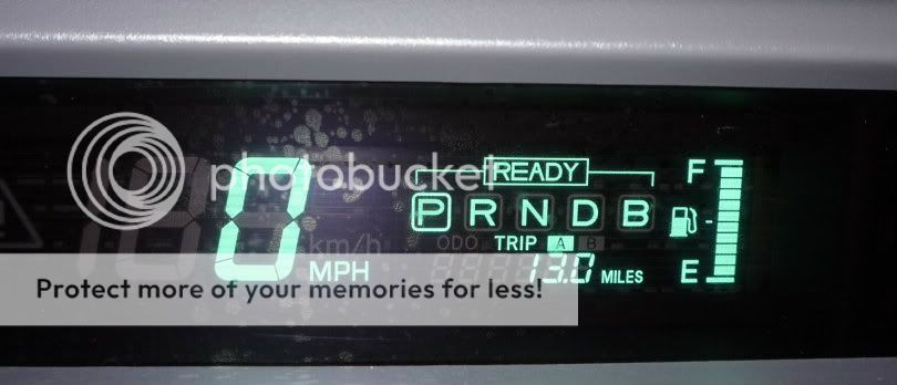

    SUCCESS!! Milibanio, this is a permanant fix not a temporary one:
    [IMG]
    Get some Blue Magic metal polish and two microfiber cloths. Rub away what I assume is the anti-glare coating that is bubbling and you get visual perfection. I have used Blue Magic for years to keep my plastic headlights clear and this stuff worked perfectly on the Prius speedo.
