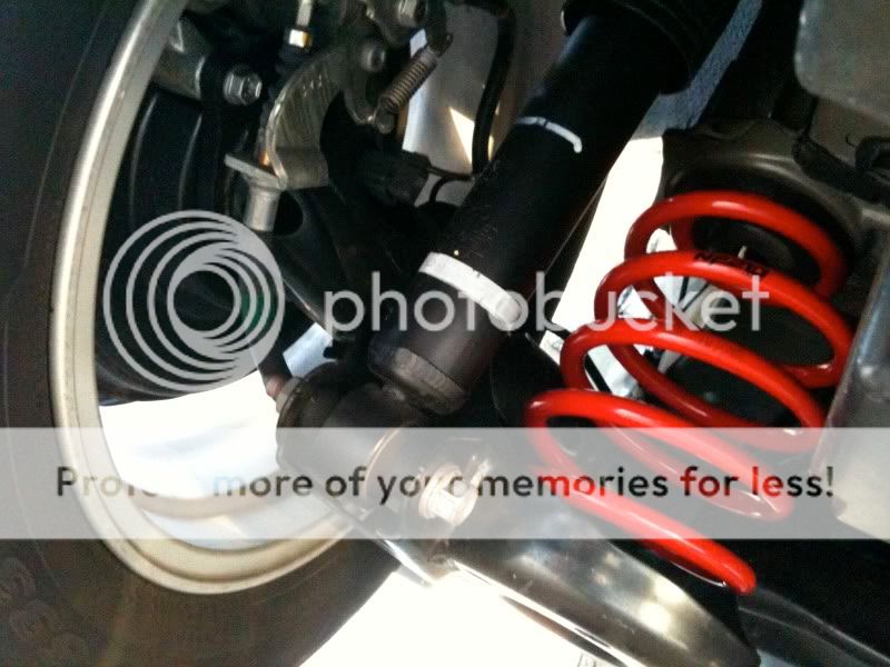

    Tanabe gave me the NF210 spring kit. (NF means normal-feeling, if that helps explain my experience). One might not notice that the car was lowered upon first glance. I will say, however, that the car looks sportier (tanabe uses "elegant" which is also an accurate description), and however subtle that might be, my girlfriend noticed right away without me saying anything. I chose this spring set over the lowest ones because I don't like the idea of having to drive it so cautiously over anything long-term. I feel these new springs are a happy medium of sporty performance, looks, and daily-driver convenience.

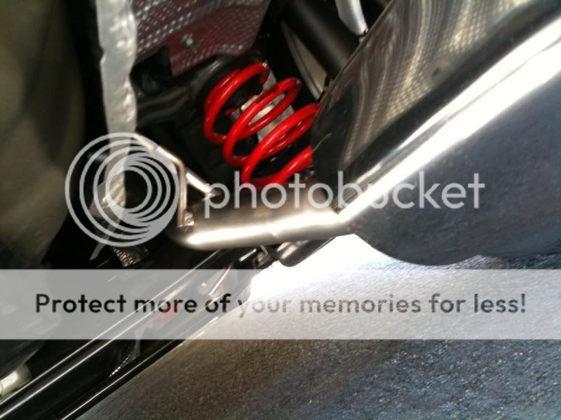

    The exhaust, which is a Concept G Exhaust System, looks....really cool. its shiny, its big (well, bigger than stock), and it doesn't look out of place on the car, surprisingly.

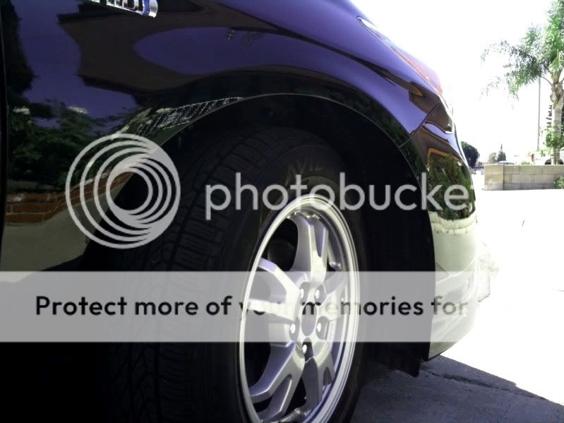

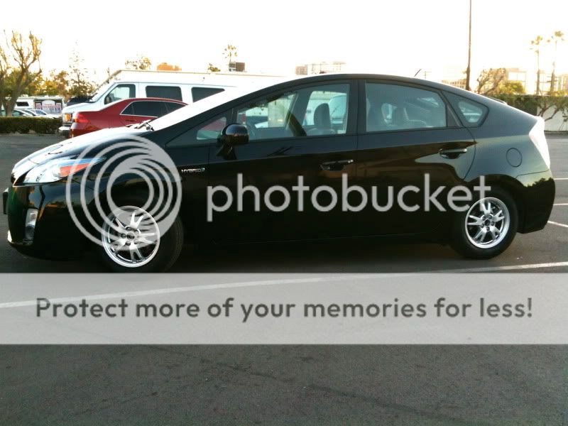

    lowered with NF210 springs, no rim covers
    [IMG]
    [IMG]
    [IMG]
    Lowered with NF210 Springs, rim covers
    [IMG]

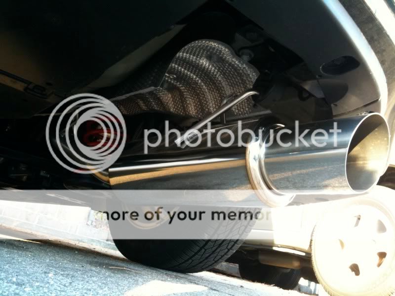

    Concept G Exhaust
    [IMG]
    Concept G Exhaust mounted
    [IMG]
    NF210 mounted
    [IMG]

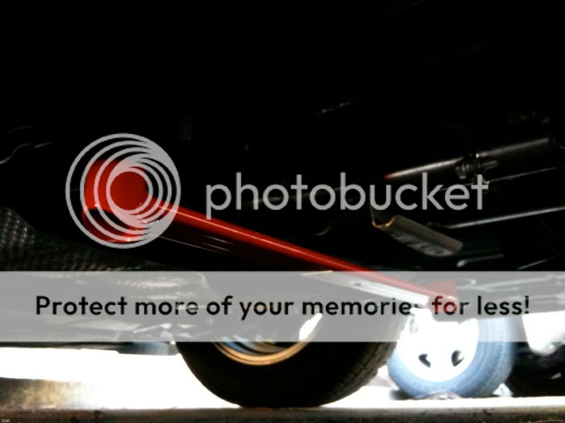

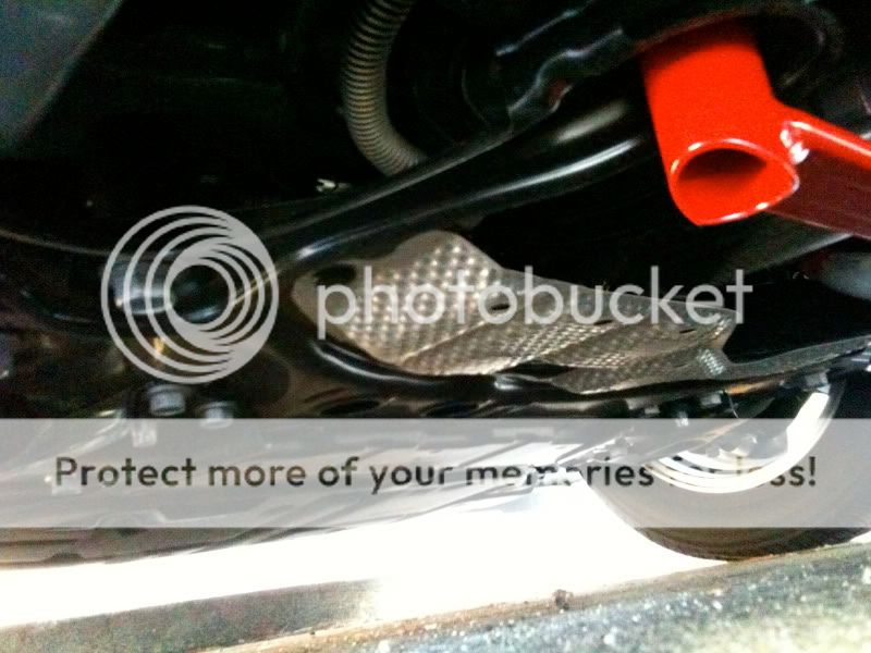

    The Sustec Under Brace is a 2-Point bar that braces the transmission tunnel.
    [IMG]
    Sustec 2-Point Under Brace (notice the stock black bracing elements)
    [IMG]

    The chassis brace, is the in the center of the bottom of the car? And can you verify how many pieces it is and how many points it connects to the chassis at? I've been trying to figure out what to get...pics would be awesome!

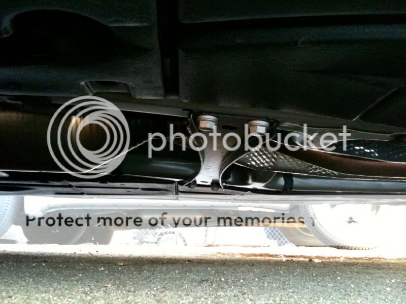

    Spoke to Michael again and he confirmed that yes, the Japan 2010 Prius is different under the hood from the 2010 US Prius, which is why the strut tower brace did not fit...it was designed for a Japan 2010. Also, It appears that of the 2 piece Tanabe Sustec under brace on the Sigma site, only the front piece was installed on my car. The rear was not tested. Perhaps the 2010 doesn't need it? Perhaps the car might benefit more with the addition of a stiffening plate? What do you guys think?
    Stock rear under-brace, no modification done at R&D session.
    [IMG]
    Ive driven the car as hard as I could all day today, and Im more and more letting go of the idea that my observation is simply a placebo effect: the car definitely has more "go" at higher speeds. Stock, the car felt like there was a HP bottleneck at around the 75+mph range. Like the car was slower to accelerate past about 75-80mph. Now, at that speed, I can still gas it and quickly accelerate higher. In fact, I was cruising at 85 with a few other cars, gassed it and quickly shot past them and up to 99mph for a minute or so. The car didn't feel like it was trying too hard either. It was definitely working hard, but it didn't feel like it was maxxed out. The exhaust sound is really pleasing. It sounds deep and muscular, but not at all loud or overpowering.
    The chassis brace and springs work together for a sportier suspension feel overall, and a slightly lowered look. It's most noticeable at high speeds though, the car feels completely in control and tight.

    A few questions regarding springs, were you allowed to "test drive" the DF210 springs? Or were they even compatible with the US model? If so, what were your impressions?
    Judging from your initial pics with the NF210 springs fitted, it's difficult to notice the drop in ride height from stock.

    Nope, unfortunately they did not. I doubt it would be very long though, considering the parts that DID pass fitment were already manufactured Prius parts. The strut tower brace will likely take a while, though, depending on whether they adjust the current model, fabricate a new prototype, or whatever.
    I basically dropped off my car and said "Michael, please try to get them to keep as many parts on the car as possible". That said, we agreed that they'd test the lowest springs (DF210) first, then the NF210 and leave em on. This is because between the two, the NF210 was almost sure to pass fitment and since they'd already be on the car, it's less work for them. I probably could have gotten the DF210, but to be honest, I've already bottomed out twice with the NF210, and for my taste, wouldn't care to go much lower (though it probably looks great).
    Yeah, thats absolutely right. It definitely takes a second of looking at it to notice exactly what's going on with the car. but, without a doubt, you can tell somethings different. I even had the luck of parking next to another 2010 here in Silverlake, and yeah mine was lower, despite the drop not being obvious. The subtlety adds something really "elegant" to the car, just a nicer stance overall. If and when I get new wheels, I think the drop will be more pronounced.

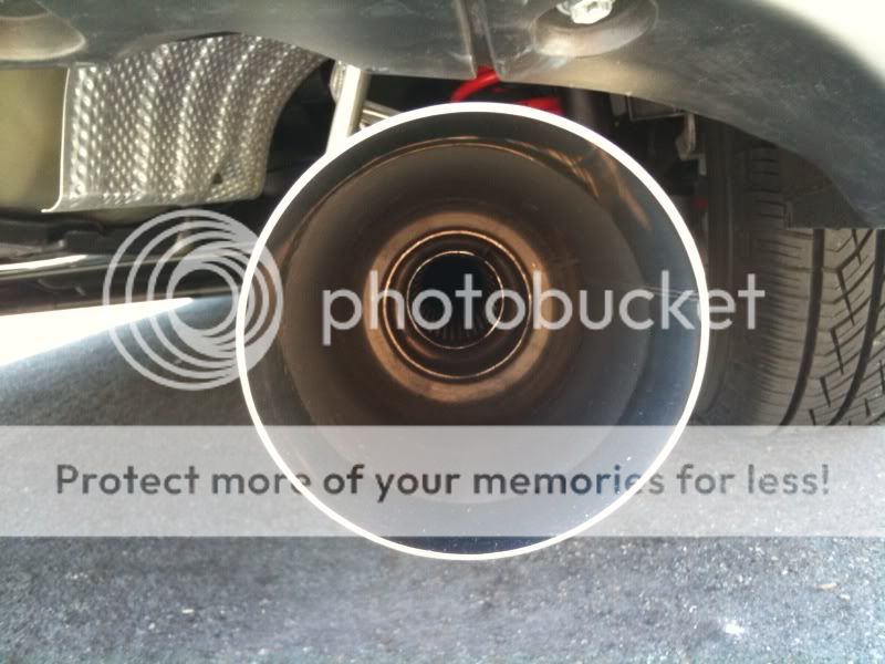

    Can you get more photos of the Concept G Exhaust System?
    In particular, I would like to see:
    • flash photo from the rear - I'd like to see if it has baffles of any kind or if it is a 'glass pack'
    • photos of the exhaust fitting - in particular the pipe from the front of the muffler to the exhaust pipe. I'm curious if they had to fab a special adapter pipe segment for the muffler (my guess.)
    Do you still have the original muffler? The new features discusses an valve that opens under high power to reduce back flow. Any photos you might have to that area of the muffler or the connector/wire would be helpful.

    Hey Bob,
    A digital dissection of the Concept G can be found here Tanabe USA Inc. - Concept G Exhaust (there are 5 red squares with pics in them. click the left-most square to see the dissected view).
    as far as pics go, let me know if this is what you were looking for.
    [IMG]
    the Concept G kit extends all the way to the front of the car, about 3 feet of piping, and looks to be designed specifically to fit the 2010 prius. I'm not quite sure what you mean tho....
    [IMG]
    I took a look at the stock muffler, and I cannot see anything on it that would indicate any sort of valve or anything atypical for that matter. there is piping, the muffler, exhaust tip, and mounting brackets. perhaps this feature is inside the muffler itself?

    Sorry for not replying any sooner....
    Tire to fender clearance is approx 2 5/8" on my car. Info may be skewed a bit since I'm running 18" rims although I kept the overall tire diameter the same as OEM.
    Tire diameters will vary somewhat between manufacturers. Also keep in mind when I took this reading I had about a 1/4 tank of fuel.
    Can someone who has 15" rims measure their tire to fender clearance?
    On NF210's I think it's typically a 1" drop. I would personally like an 1 1/2" drop.....:D
