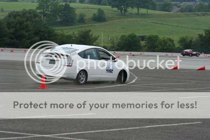

    Nice! Looks to run pretty flat without the factory body roll.
    I miss autox. So much more fun than drag racing.

    OEM body roll is mostly gone. Autocross is much more rewarding. Much more driver involvement than drag racing.

    I'm impresed with your use of 15s. I would have thought they would rolls over too much. What pressure do you run and do you put dial-in/shoe polish to check for side wall roll over?

    03-08 Corolla bars, TRD in rear. Been researching dampers, Tokico HP's fit on the rear no prob, just can't use Eibach Pro-Kit with them (won't fit around spring seat). The fronts however are a different story. Steering knuckle is thicker on a Prius so still debating on my approach to installing the Tokicos on the front. Tire pressures today were 36 fr and 41 rear to help the rear come around. Still getting the alignment just right but she gets better every event. I normally do chalk the tires but lately just been going by feel as to what I want the car to do and adjust PSI from there.

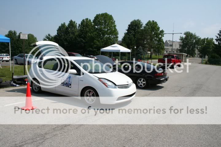

    this car looks quite low, and I see you have Ground-Control Coilovers for a Toyota Matrix (as GC dont offer equipment for Prius).
    How easy was that? are they a straight swap?
    And these rims are 15" ?
