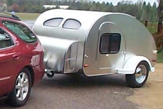

    So....now that I have the Prius......I'm thinking about buying a tear drop trailer for some weekend camping....[IMGLINK]

    they typically weight about 1000 lbs and have a 90 lb. tongue weight....

    This travel trailer weighs about 560 pounds empty. I've towed it about 600 miles so far, and I'm generally happy with it. The only complaint is the 32 mpg. I guess the aerodynamics could be a bit better... The power is adequate, certainly better than many trucks on the same roads. And this with a Gen2 - a Gen3 has considerably more power.

    I have used my 2009 to tow and launch my 17 foot day sailor - the trailer and boat weigh about 750 pounds and I have been very happy with how the Prius handled it. Your trailer will likely be heavier, but aerodynamics should be a world better than a sailboat.
    On my commute someone has a Tab teardrop trailer parked in their driveway. It is awfully cute and in looking at thir website it seems to be very well thought out and cool.

    The red part is the Harbor Freight foldable 4x8 trailer. They have another one that doesn't fold that's rated for a bit more weight. They have sales all the time, plus you can usually get a 20% off coupon. I think I paid about $240 after all the games, down from $400 list.
    The brown part is 4x8 sheets of 1/2" plywood from Lowes/Home Depot. Plus some 2"x2" for bracing and to attach the plywood at corners.
    All of the ready made teardrops that I've seen are a lot heavier than the 560 pounds that this one came out at. That may work with a stronger car, but I was trying hard to keep the weight at a minimum with conventional materials. A conventional teardrop shape is certainly more aerodynamic, but also an order of magnitude more difficult to build.
    As for plans, buy a trailer & cut some plywood to fit. The two sides clamped together and cut as one piece, including the door openings. Other than that, the smaller pieces were roughly cut oversize, assembled, and the excess trimmed off with a router.
    The first upgrade that I'd recommend is to use a 5x8 trailer with 5 lug tires. But that's another $400 and a few more pounds. Plus you'd have to either build up some 5x8 sheets of plywood from 4x8 stock, or use 5x10 sheets at 4x the price. It's a 4x8 world out there...
