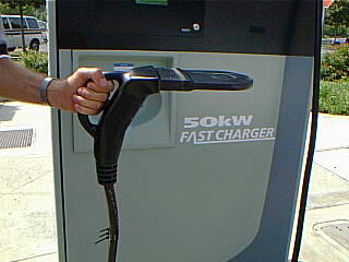

    Agreed! This very issue was discussed in a previous thread a couple of days ago:
    http://www.priuschat.com/forums/2-vt9480.h...r=asc&&start=20
    But remember that 50kW chargers were available 7 years ago (nice article on 12 minute recharging here), so 100kW chargers would be pretty easy to make and could charge your vehicle in only half an hour. But as discussed in the previous thread, charging will most likely occur more slowly while parked in work and supermarket carparks.
    [IMG]
    (Edited to add a picture to show what GM's 1998 50kW EV charger looked like) :)

    I think you missed the "h" in 50 kWh.
    The charger you reference and show a picture of is a "50 kW" charger, notice that the "h" is missing. Watts is an instantaneous measurement and does not measure the total quantity of energy over time. "kWh" is a quantity measurement over time, and 50 kWh is equivalant to 50 kW delivered continuously for an hour. The electricty usage of your home on your power bill is specified in kWh.
    So, a 50 kWh battery is capable of supplying 50 kW of power continuously for an hour. (In reality, that's a normalized unit, so a given battery may not be able to physically supply 50 kW continously for an hour, but may instead be capable of say 25 kW continously for 2 hours, or 5 kW continously for 10 hours.) Therefore, it would take that 50 kW charger an hour to charge a 50 kWh battery.
    The article you quoted stated that the charger could charge a Chevy S-10 electric pickup truck from empty to almost full in 12 minutes. That means that the truck had a battery slightly larger than 10 kWh. (50 kW delivered for 12 minutes is equivalent to 10 kW delivered for 60 minutes).
    Now the Chevy truck had a range of only 60 miles. A general purpose car needs a range of around 300 miles. So, if the Chevy truck had a 10 kWh battery to go 60 miles, it would need a 5 times larger battery to go 300 miles. Hence the 50 kWh battery assumption for a general purpose EV car.
    So, your 50 kW charger would charge a 50 kWh EV car in one hour (way too long). To charge one in 12 minutes (still too long in my opinion), it would need to be a 250 kW charger. To charge it in 5 minutes (probably reasonable) it would need to be a 600 kW charger (0.6 megawatts). To charge it in 1 minute as you implied in your original post, it would need to be a 3000 kW charger (3 megawatts).

    No I didn't - I was refering to power, not energy. The charger shown is capable of dishing out 50 kW (kilowatts). Plug it into your car for 1 hour and it would provide, as you say, 50 kWh (kilowatt-hours). Agreed a 1 hour charge for 300 miles is probably too much of an annoyance for most people. But a 100 kW charger would only take half an hour and any problems of heat etc could be overcome. A half hour rest stop every 5 hours driving (300 miles) would probably make sense and allow filling-stations to make a little extra cash from the refreshment side of things.
    I will concede (as I explained in the previous thread on this subject) that the 1 minute charge would not be practical due to the extremely high voltages that would be required to keep the currents low enough and the problem of venting the excess heat. But 100kW is easily achievable and I think 30 minutes recharge seems a reasonable compromise. Remember that at this rate stopping to plug-in for only 2 minutes would give you 20 miles range - likely enough to get you home or to the shops where it can charge to full.

    One thing I found very interesting about the article you posted was that they were using induction to transfer the electricity to the car's battery. Basically, the paddle on the charger has wire coil in it, and the receiver in the car also has a coil. The charger's paddle creates a magnetic field and the car's coil converts the magnetic field back into electricity. Just like the way a transformer works.
    That would certainly solve the issue I had with spot-welding the connectors together, as there would be no metal-to-metal contacts between the charger and the car for the electricity to arc across. It would also be safer because everything would be insulated and the high-voltage electricity would be unable to arc through the air to something else, like the customer. I wouldn't want to go near one if I had a pace-maker for my heart, but other than that, it's a pretty cool idea.
    The downside of it, however, is that there would be a significant efficiency loss if you use induction to transfer the electricity. More electricity will pass through the charger's coil than will flow from the car's coil to the battery. Transformers typically use a ferrous core to magnetically couple the two coils to increase the efficiency of the transformer. The induction paddle charger would effectivly be using air (and plastic) to couple the two coils, which would be fairly inefficient.
    I have no idea how inefficient it would be, but it might even approach the effiency loss of using electricity to extract hydrogen from water and then using a fuel cell to convert the hydrogen back into electricity. Particularly if you add the 10% or so efficiency loss you get during the transmission of electricity from the power plant to the charging station and charging efficiency of the battery (???? 10%? 5%?).

    As for the inductive-charging issues, it's really rather efficient. A transformer is typically >97% efficient, and the paddle isn't much different from a transformer. It would be pretty easy to insert a ferrous core into the centre as the paddle is inserted too (maybe it does already - never seen one!).
